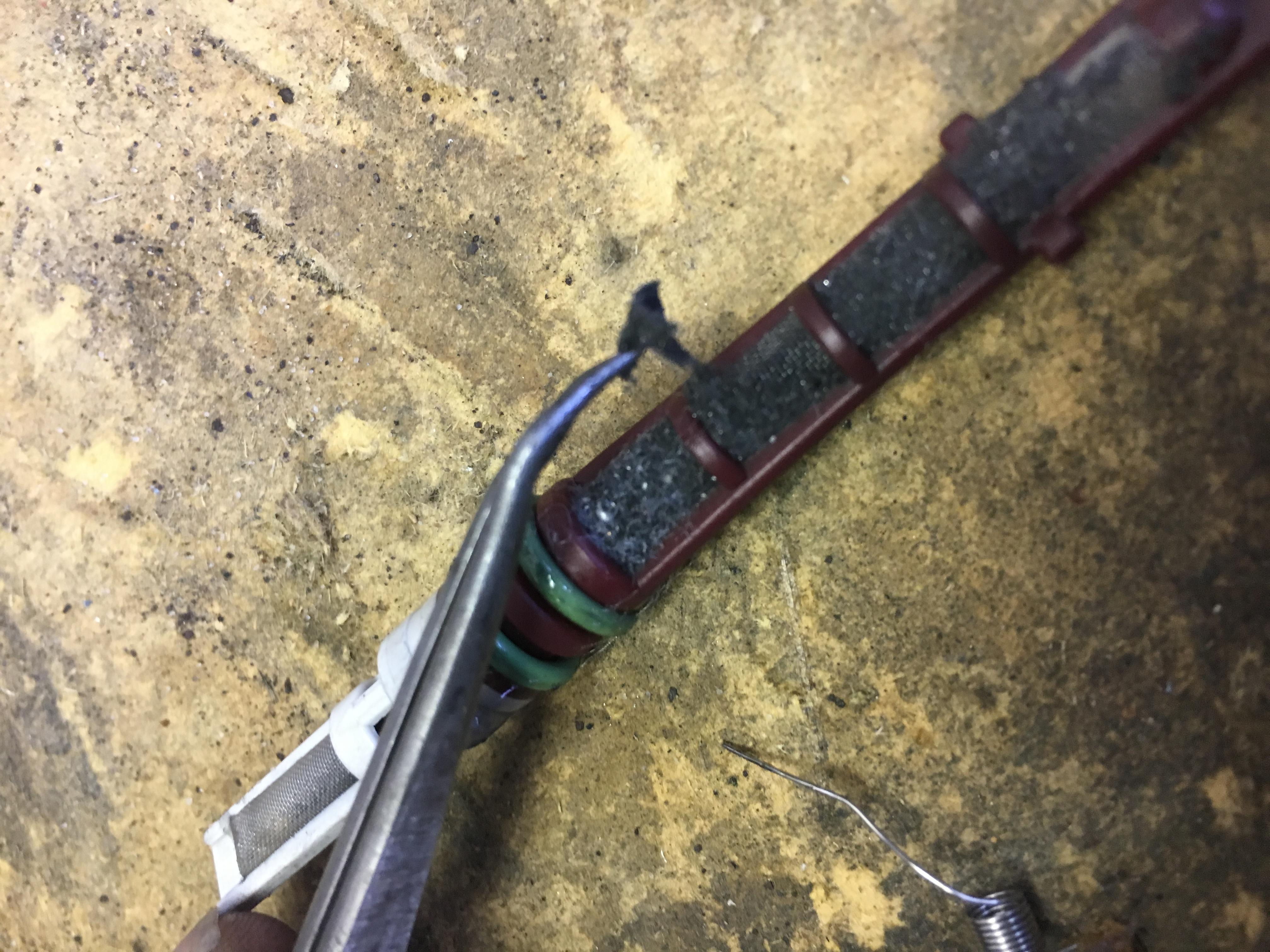

A/c problem on my 02
Bobs 7.3
Nov 2, 2012
189
Plymouth, P.A
My a/c is almost warm at idle so I put in a new orifice tube and the one I took out was packed with what looked like aluminum shavings and this is the second time I've done this but last time was 2 years ago and the a/c stayed cold till now. This time still almost warm at idle and only gets cool till above 2k rpms for atleast a minute so I think after this metal the second time it needs alot of new parts. I was thinking a full aftermarket kit with all the o-ring, dryer, compressor, orifice tube, oil and condenser. Put it all on and have the system flushed, vacuumed and charged the proper way. Has anyone used those aftermarket kits before? Do they work well?

I replaced compressor, orifice and accumulator, flushed, evacuated and charged. It did good for 2 years, then started to get warm. When I checked pressure, the high side was a little high at idle and way high at 1800rpm. The orifice was clogged with crap, so I replaced everything except the evaporator (I get the parts cheap) and now it's good. Either I didn't flush the condenser good enough, or the hoses were starting to deteriorate.

The new orifice did wonders 2 to 3 years ago but thus tI me the compressor I know is just shot so I'll just change everything but the hoses and evap but I'll flush them out really good before I button everything up for the vacuum and recharge. Pull your orifice n if it's packed with metal aluminum looking shavings then your compressor is failing.. you can then try a new orifice and recharge but eventually you'll need a compressor and a really good flush. I just ordered the a/c filter that goes between the lines and the compressor as it catches any metal shavings left that the flush doesn't get out before it ruins my new compressor.
