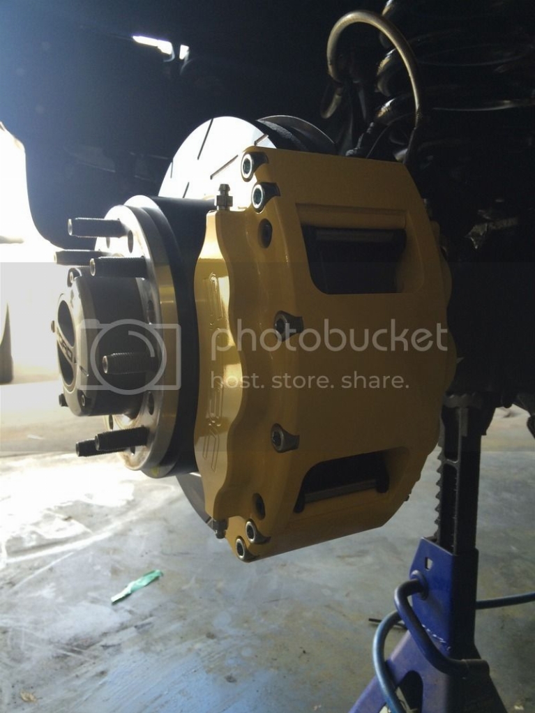

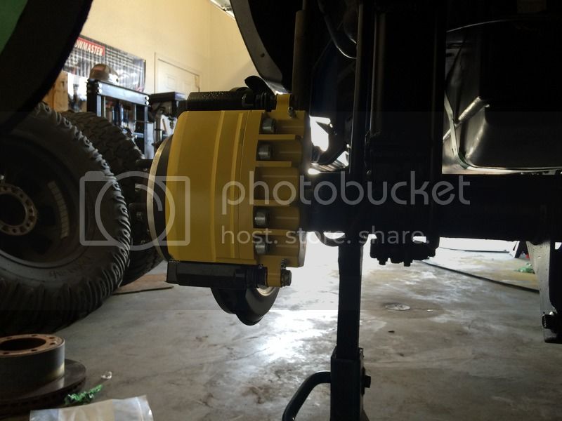

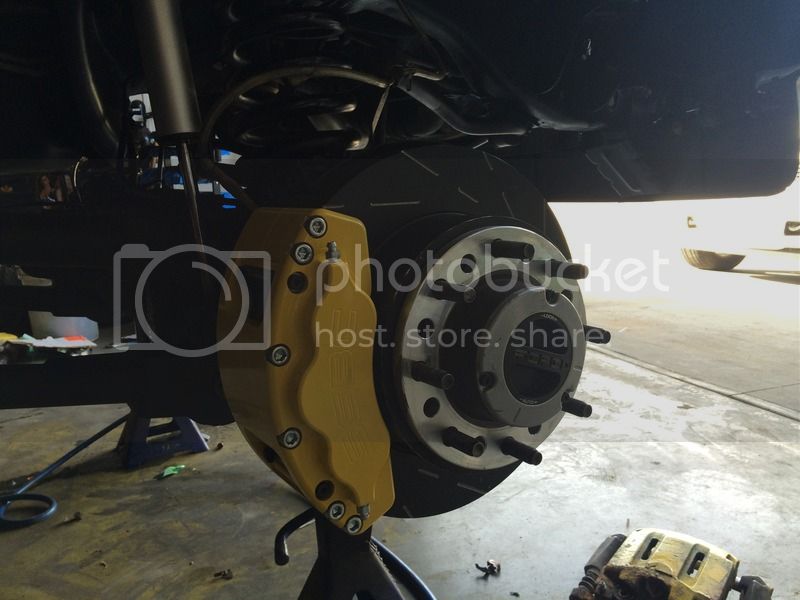

Ssbc makes a factory sized 6 piston caliper and cross drilled and slotted rotors priced about half of what wilwoods cost. Anyone run a set of those?
footlong70
Nov 1, 2012
115
Whitecourt AB
I've been running the ssbc calipers front and rear for just about a year now. They came with their own pads which I'm also using. The front 6 piston set are a complete caliper replacement that use a different style of pad other than stock. So stock pads don't fit. Rear 3 piston calipers is a partial change but use the stock style of pad. I also upgraded to the ebc slotted rotors.
Overall they are are decent. I can't say I was wowed by the stopping improvement but there certainly was improvement. The front pads are fairly dusty. The biggest improvement was that the new calipers look a lot better than the originals. Its still a couple grand upgrade, but much cheaper than any of the other caliper upgrades available like said.
