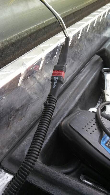

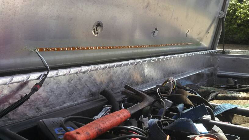

uploadfromtaptalk1400274619909.jpguploadfromtaptalk1400274631419.jpguploadfromtaptalk1400274646425.jpg
I really need to do something with the wires coming off of the strip before they break off.

I've been heavily contemplating this, but haven't settled on a light source. Mainly because I was worried about the brightness and the dead zone in the middle of the bed. It appears the brightness of your lights is perfect. But misses the middle. Can you shoot a pic of the placement under the bed rails?

If you know someone who has a wood shop, take a 1"x1" piece of wood. Have them rip it down the length of it at a 45 degree angle. Then epoxy that up in the corner of the bed rail. That should project light out towards the middle of the bed more. And since the LED strips like the one the OP used and the ones I got off eBay are a 180* spread of light, it will still hit the sides of the bed and the middle.
