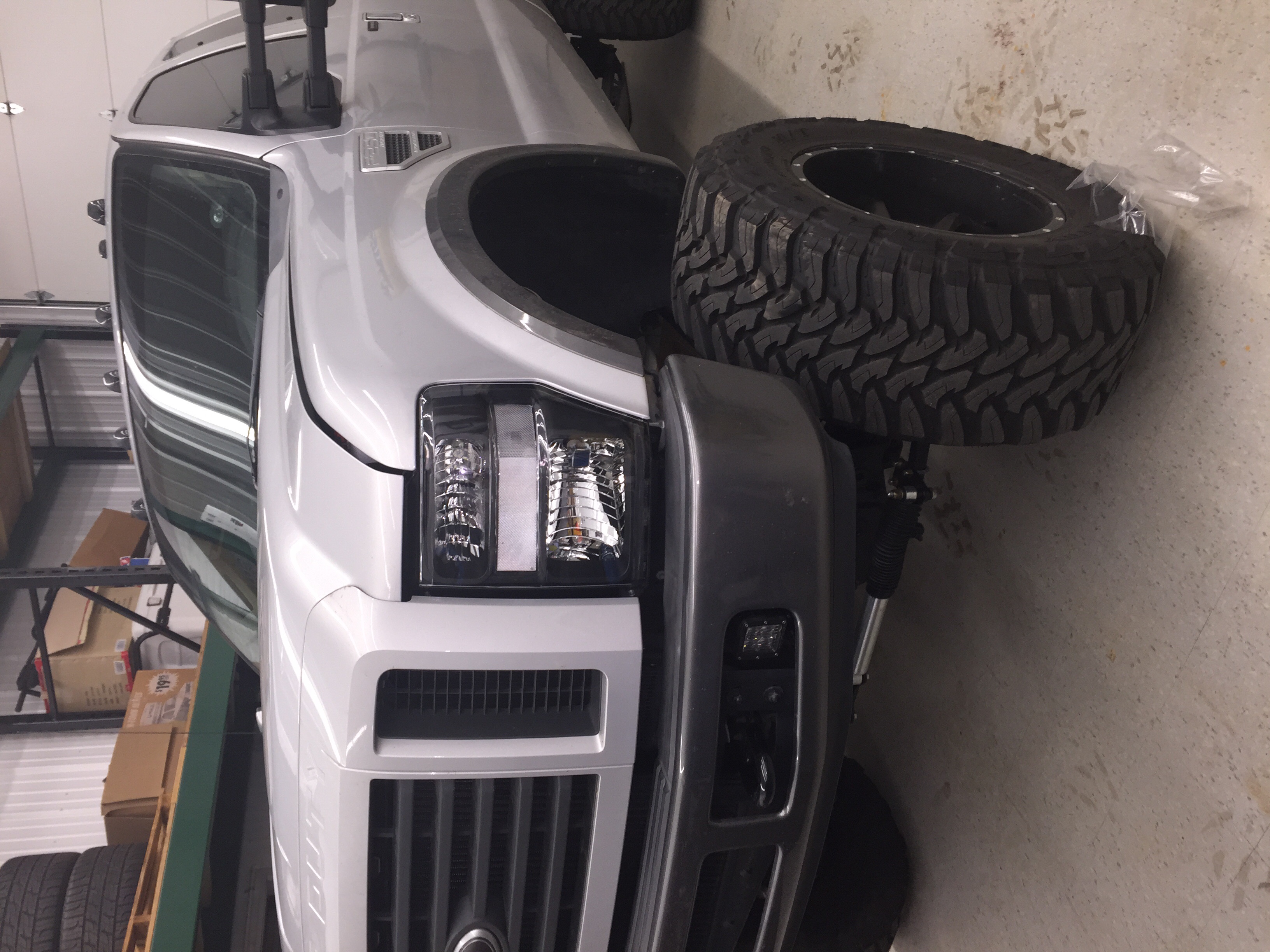

Heres mine ebay classy. 320$

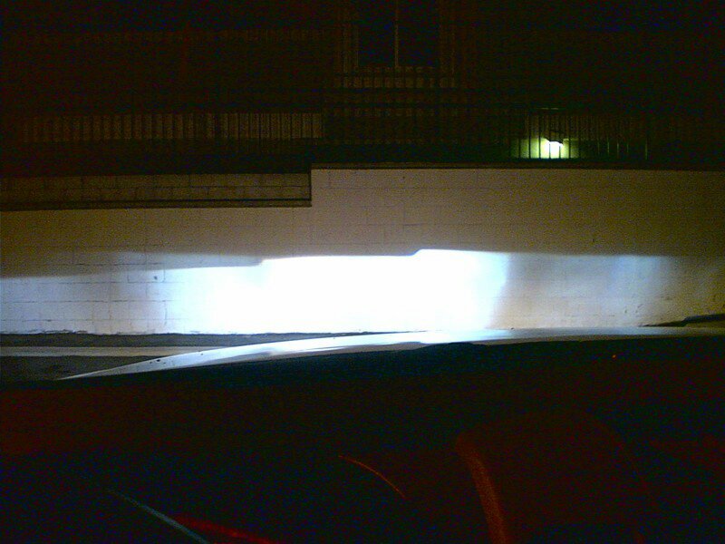

Any pictures of the output and cutoff?

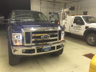

I did all of it myself and would say for the cost compared to other products or a retrofit done by some companies I would say it is infinitely better

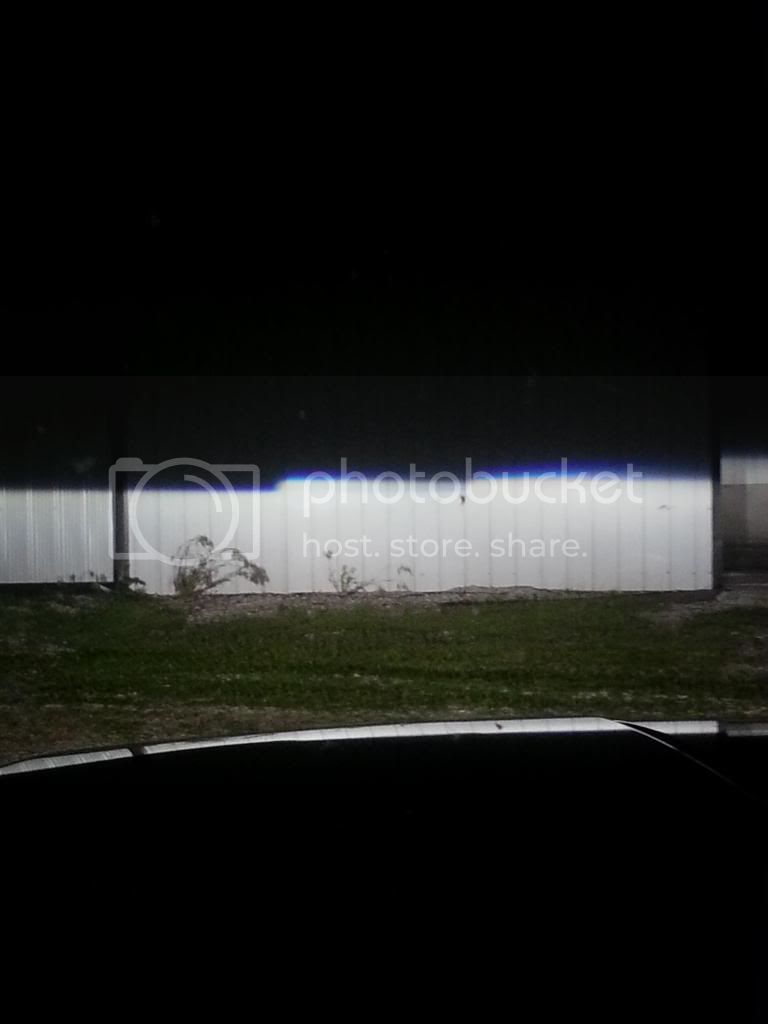

The light output. It would look something like this. The cutoff is the line separating the regions of light and dark.
That cutoff is very crooked and the hotspot is way too low. It should looks a little something like this instead. Except this was before i got OEM CBI bulbs so the passenger side cutoff is a bit blurred
Lol agreed, that was just a picture I found online. My cutoff is much better

Sorry I haven't been able to reply until now but I would say it's a pretty easy process. I removed all the lights and rubber surrounds for the main headlamps and preheated my oven to 250 IIRC. I left them in for 7 minutes on a piece of cardboard and then proceeded to pull them apart with two wide tipped screwdrivers. Once both lenses had been removed I removed both chrome dishes and hit them with a heavy duty oven cleaner and 600 grit wet/dry sand paper. I washed them off and let them dry then gave them a coat of plastic adhesion promoter and then painted them with color matched paint. As far as the projector retrofit itself I would advise looking at TheRetrofitSource.com as they provide good instruction and were extremely helpful throughout. The only thing I would caution is: 1) Make 100% sure you have the tilt and inward aim aligned perfectly on the projectors and I would advise not using the FX-R as they are a MASSIVE projector and did not fit as well as I desired. 2) Be sure to clean all remnants of old sealer out before resealing lens. 3) The wiring I received needed to have two of the wires switched and repinned to have the brights operate correctly. Take your time and you'll probably enjoy this process, because I know I did.
