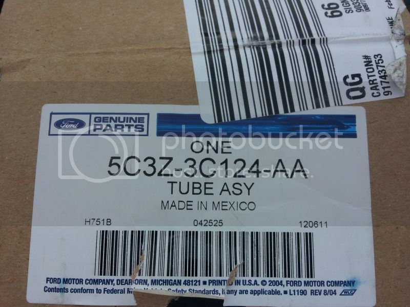

Turns out it wasn't even the lines going to the hubs, found one of the plastic joint connections was snapped under the hood. Pulled the broken piece out and reinserted the line. Then had to unplug the pump electrical connector and replug it so it would kick on. The vacuum reservoir was obviously empty. Need to let it run some more. Anyways, here's the ford part number as promised...
