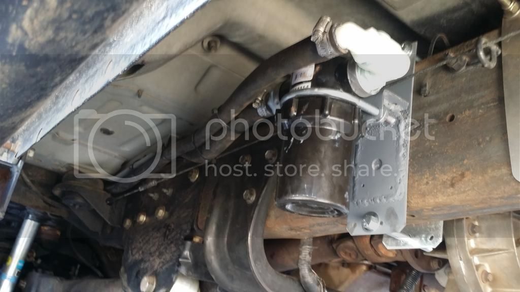

Yessir. Turned the doghouse around, hosed it uphill then back down to the top of a sealed container. Back out about halfway down the container, hosed to the stock location on the inlet tube.
I can get pics, but it'll be friday, working dark to dark right now.
I drain my container every oil change as Arisley said.
Jomax
8,576
8
Arizona
That's what I did, still need to paint the bracket.

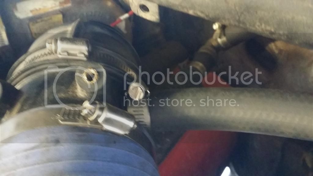

This is how I did it at the motor
