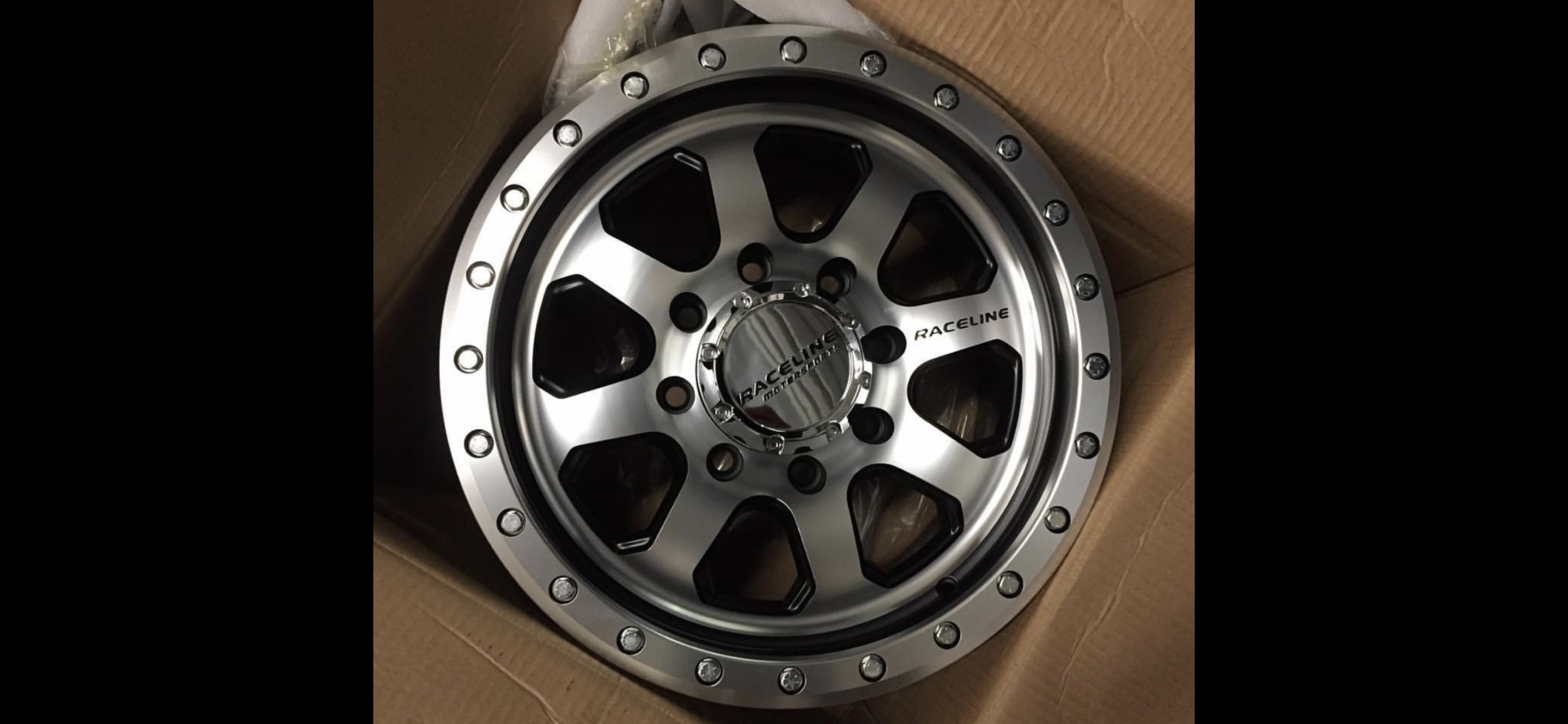

I’m going to change the look up a bit going to a rogue front bumper. Some 17” race lines and 37” Toyo mt and possibly a 4” lift depending one the clearance of the 37s
I think it’s going to look good setting really bored with the truck. I almost traded it for a dodge then came to my senses and I’m going to keep it for a while longer

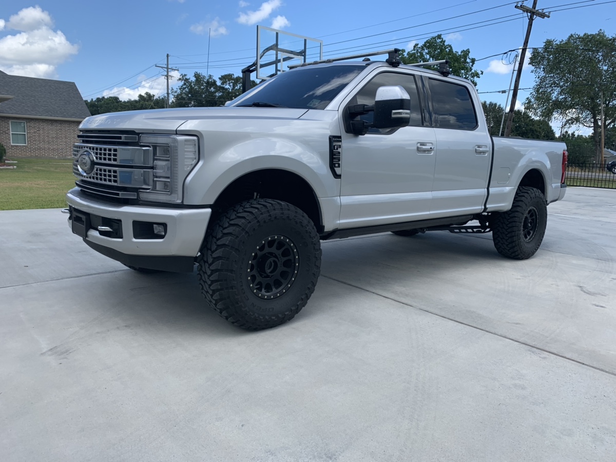

I'm really late to the party but...
You can run kings(or any shock with a resi) with stock wheels if you mount the reservoir over the coil...OUO, PMF, Carli and others I'm sure make the mounts. IMO that's the easiest way to not rub. My Icons were piggyback on my 14 and had to be rotated to avoid rubbing on the tires(stock wheel 35x12.50)
I REALLY love how a silver truck looks. Also you should be able to clear 17x9s and 27s @ 2.5" I'm 90% sure my buddy has that setup on his 19(well 20x9 methods, 37" ridge grapplers 2.5" OUO suspension)

Yeah, I’ll let you know tomorrow just got the tires and wheels today. If it comes to that I will change to a remote mounted reservoir.

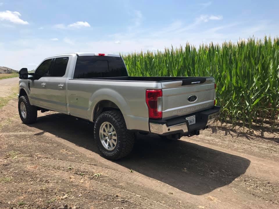

Thanks for pictures. That’s a tough decision I like them both. The only upside would be the 4” giving me more clearance off road.

Post some pics up once you get that all done glassman. Love the new tire/wheel combo you chose. Curious to see how it looks with the 4" setup
