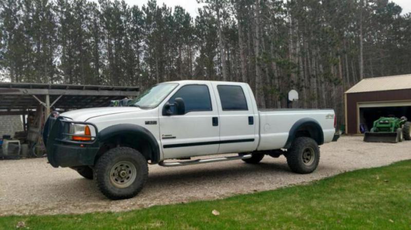

Picked this up instead of messing with the OBS. It is a 2001 180k miles. Dana 60 truck but unsure if it is forged or not. Build date is 12/00.

That truck should have PMR's, but you said you're only looking to make 425rwhp so you'll be fine.

I wouldn't trust that list, especially 15 years later. Pull the inspection plug behind the oil filter. If the rods have bolts they're PMR's if they have studs they're forged.

Truck was a 12/00 build date, will pull the plug today and see what it's got. Ordered some bellowed up-pipes and a gen 1 wicked wheel for it. Truck has a full 4" turbo back and a nice CAI setup. Have a cheap Dfuser 18k module I may throw on it for a few horsepower. Planning on upgrading the transmission cooler also. Nicest 7.3 I have owned to date.
