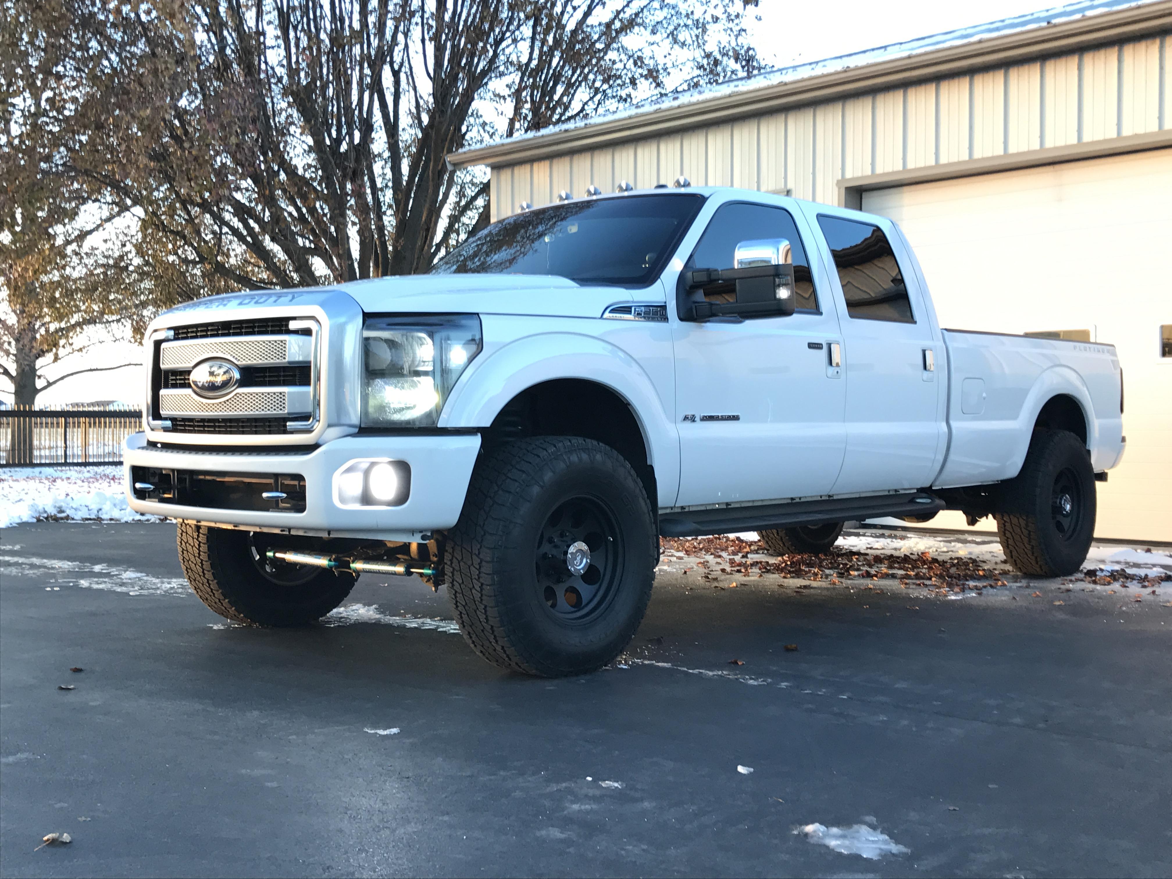

I was definitely wowed with the change of driving characteristics after installed my pmf dual setup with kings almost 2 years ago now. Love it!
