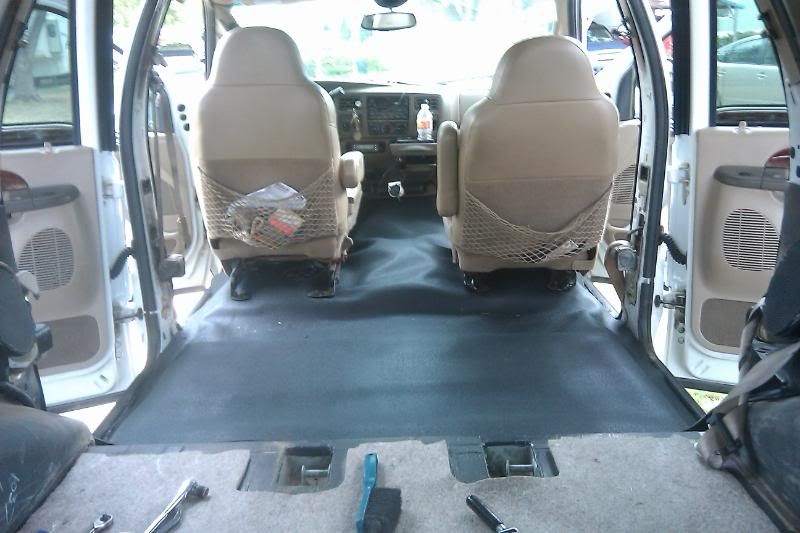

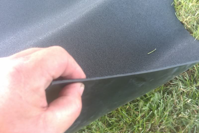

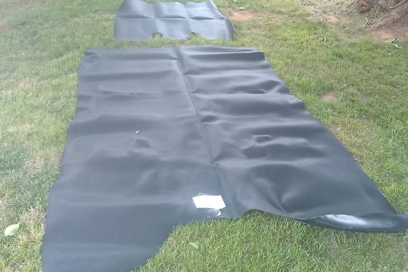

This stuff is much thicker than the OE vinyl floors in my F350 and comes with OE-type padding/insulation. Here's the kit all laid out (except insulation):
Its THICK!

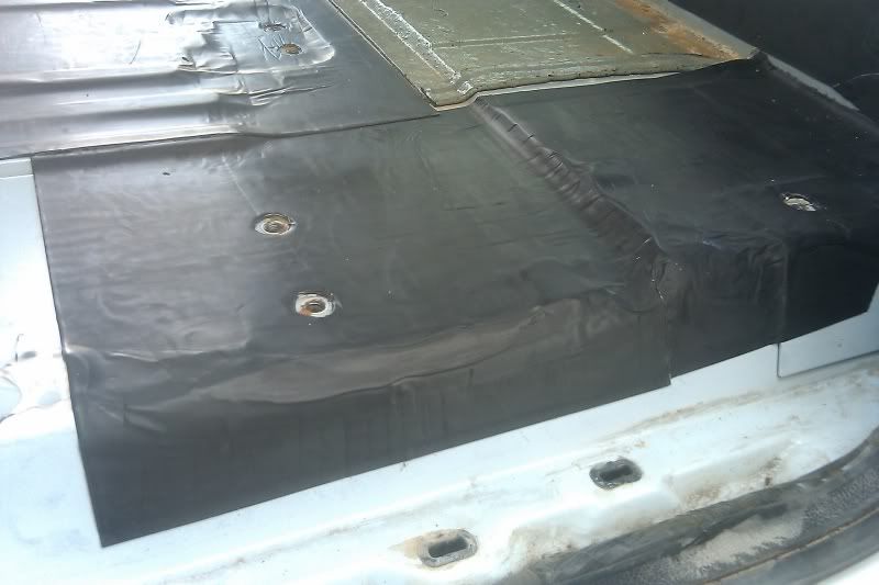

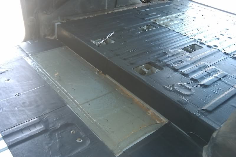

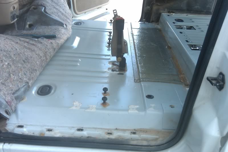

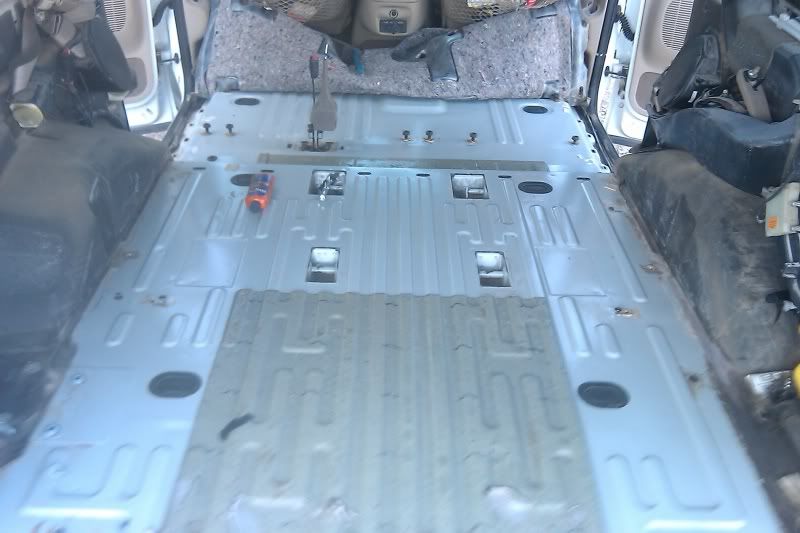

Since I'm driving the X, living in TT and working 70+hrs/week, its been a little slow - but first I pulled all but front seats, the trim and rear 1/2 of the carpet:
Then, I installed thermal/acoustic insulation (like dynamat, but less expensive) - http://www.secondskinaudio.com/vibration-mat/damplifier.php?category=120

Btw, I drove up to Wichita with the rear trim panels off - OMG is it LOUD without them!!! Specifically turbo-whistle. I'm gonna see how much insulating I can do to the body in that area and maybe put some on the back-side of the panels to supplement the factory stuff...

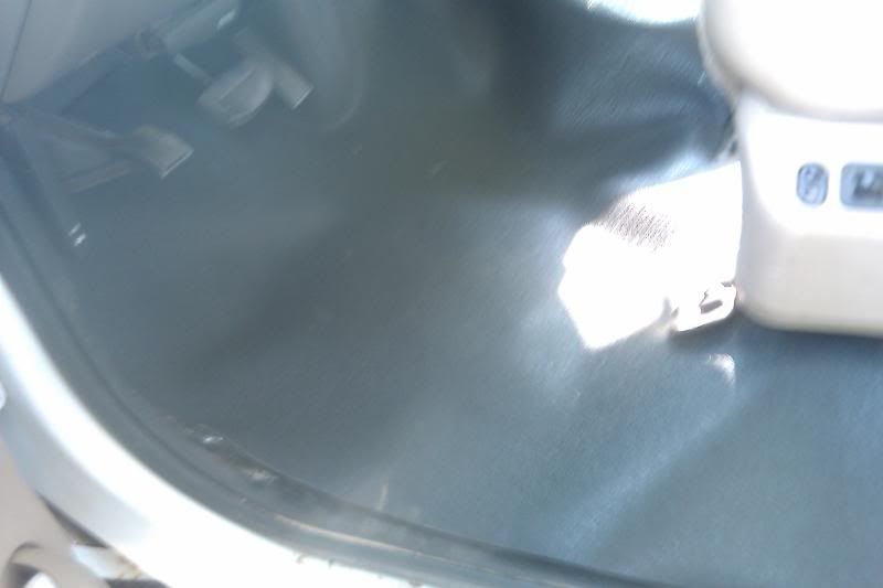

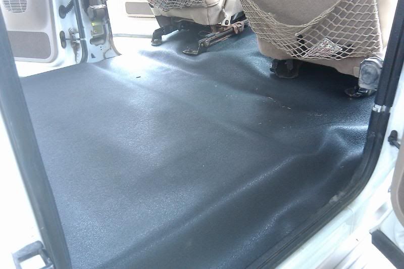

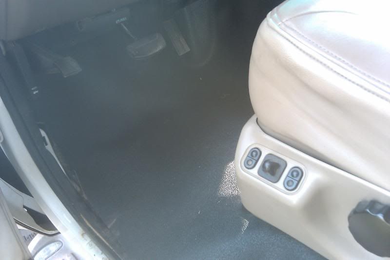

It didn't lay 'factory flat' in front of the front seats. I'm hoping a set of Weathertech or similar floor liners will go over the vinyl and give me the OE look I really wanted - but I'm not sure that will be enough to get me to recommend the vinyl (for an X anyway). I should call ACC and see what they say...
From the front seats back it is 100% OE fit and finish and I LOVE it. :toast: Not sure if its the goofy center hump in the X or just the dum rednek installer, but I tried every which way to get it to lay flat up front.

It might relax a bit in the summer heat. I wouldnt go too crazy till then
ColtonP
Sep 13, 2011
1,561
Tyler, Tx
Mine didn't lay flat either. I let the truck run with the heater on for 5 hours and it helped a lot. After driving it for a few weeks, it was fine.
