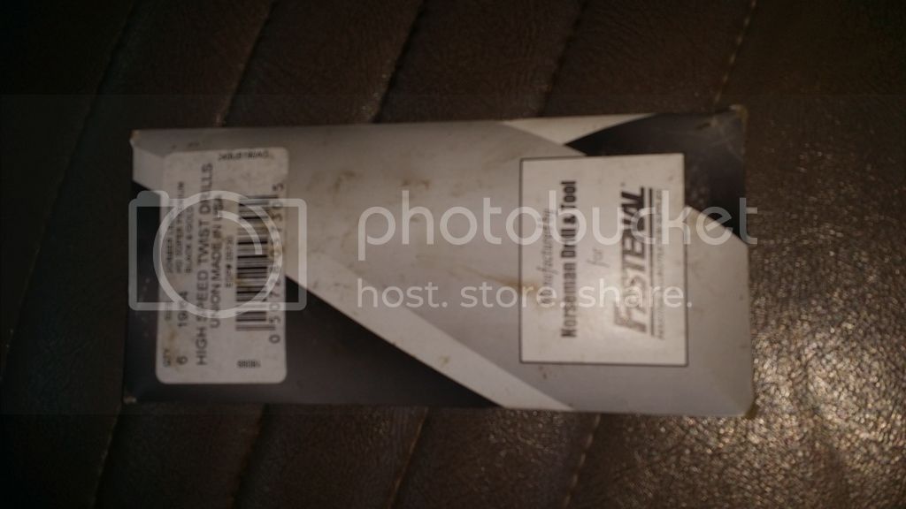

TyCorr
Jun 23, 2011
15,461
Heres the efffin muthaeffas that i use. I buy 1/8 and 5/8 from them too.
WHY NOT
Jun 21, 2011
3,912
Carlyle IL
I got a bunch of fastneal drill bits that are dull as hell. When they are new they cut like crazy though.
