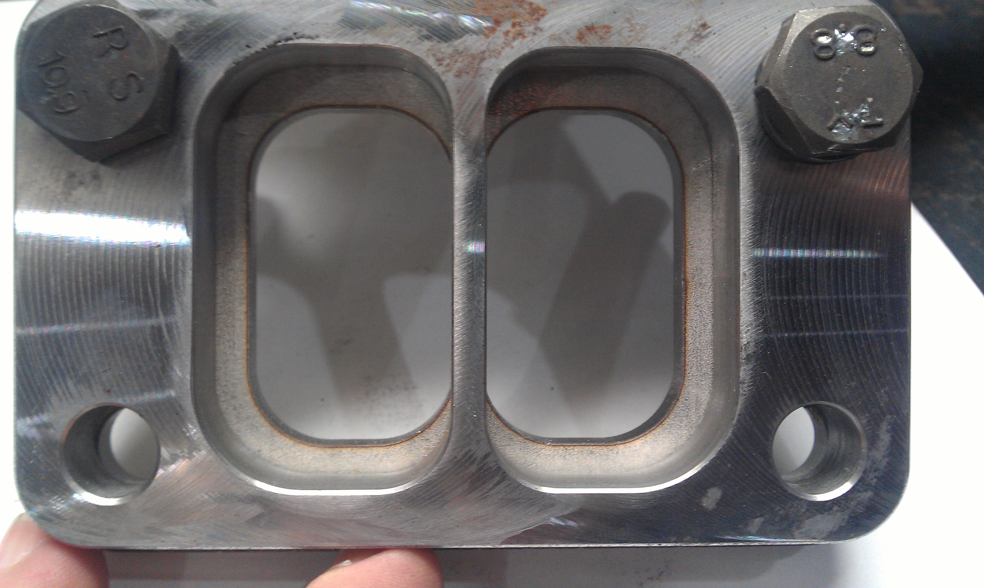

Here is a picture of standard T3 port sizing, compared to what I run.

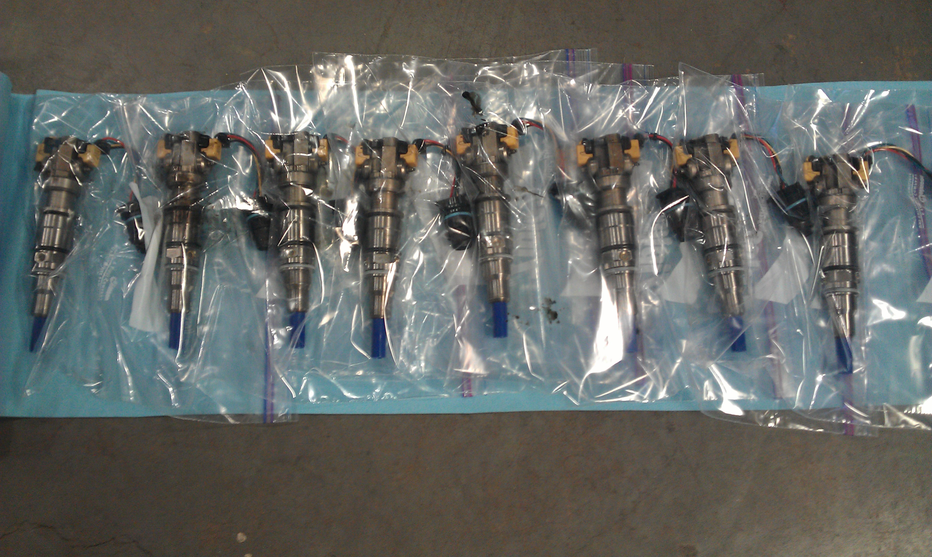

Injectors pulled, quick Brakleen, silicone injector tip protectors, ZipLocked, packed, stuffed, and ready to send to Jesse.
