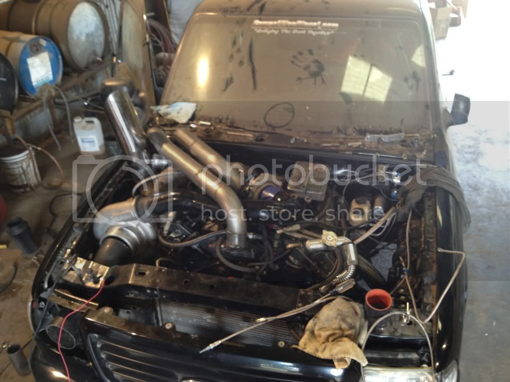

new intake and maybe the hood stack. Havent decided if I like this tip on it yet.

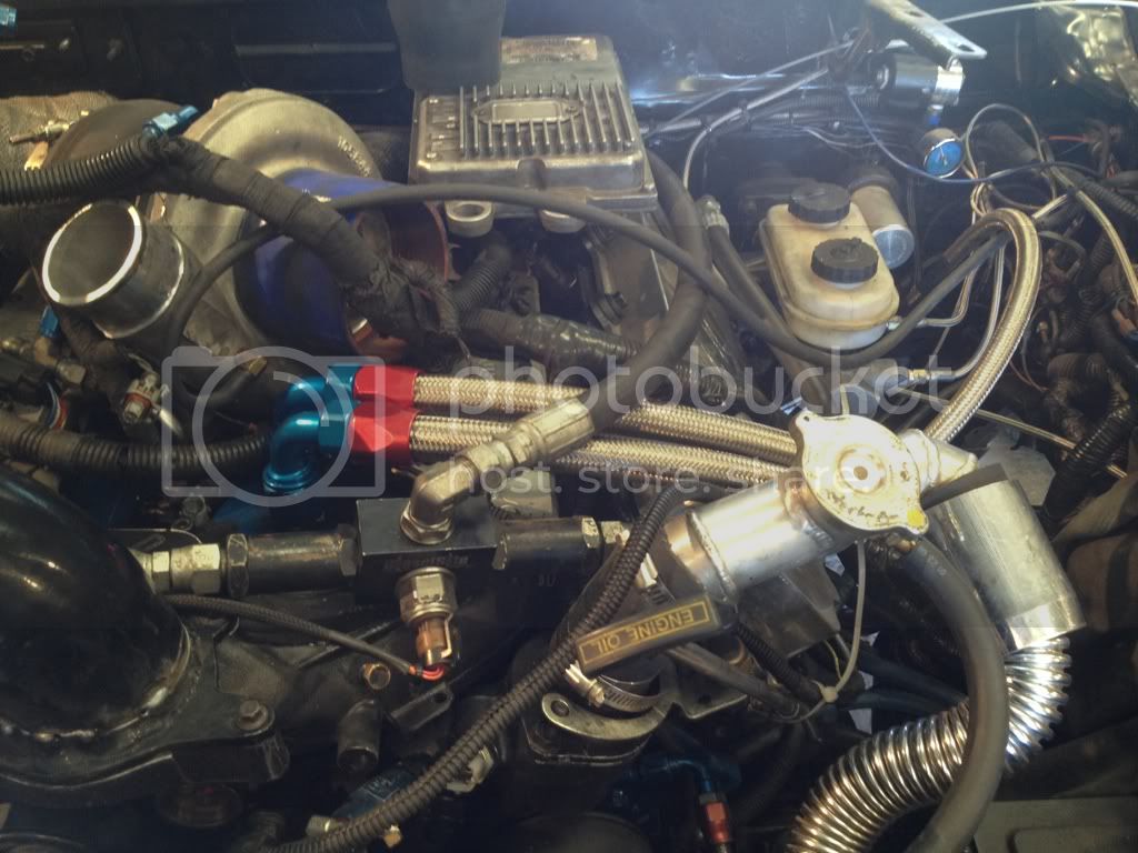

we started with 12an lines on our ranger and never had an oil problem. on cold starts low pressure oil is steady at 100 psi then drops to around 70-80 psi when hot. 12an will do you right.

So on a 6l where does the fuel come in at? Im thinking 7.3 my bad. I have never owned a 6l. Looked normal to me. oh well.
Stoopid noobs
there are ports on the front and back on the heads. If you look at the bottom of that pic there is a -6 line with a 90. Thats the fuel line
Cutting-Edge Diesel
Feb 10, 2012
5,738
Newkirk, OK
changed up the charge pipes a bit. Making them a little simpler to remove and install. Tested the electrical systems today. Its ready to fire. Just have to wait for the filter base to get here.
