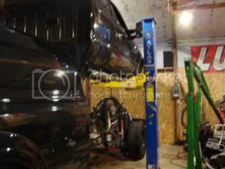

, Stu the mech at TUFF ENUFF Diesel in nwi , is knocking it out , I'm able to help if needed opcorn:, Everything looks good inside rockers ,valvetrain (im replacing) , injectors , pistons

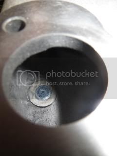

, The Drivers side Number 1 i think was where headgasket blew out

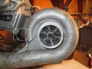

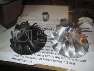

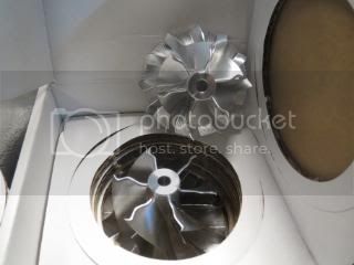

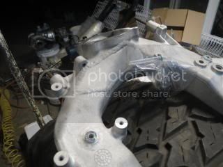

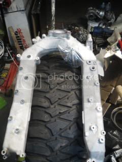

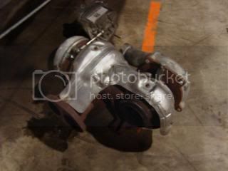

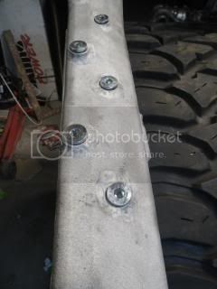

, Heads go in for looking at and planing them (getting a price to port them) , and picked up intake so i can ,make a swap for my new DD ported intake , Also Brought the turbos home so i can ,install LP/HP batmowheels

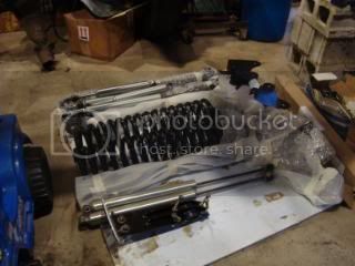

, also want to say thanks to craig at MPD for the super great deal and super FAST shipping on all my products :thumbup: ,I will Keep Pics updated He's looking to start reinstall by saturday imp:, Also getting an 8" BDS ,4Link suspension upgraded shocks with rear springs , I had the Road Rhino Bumpers powder coat all pieces gloss black ,
