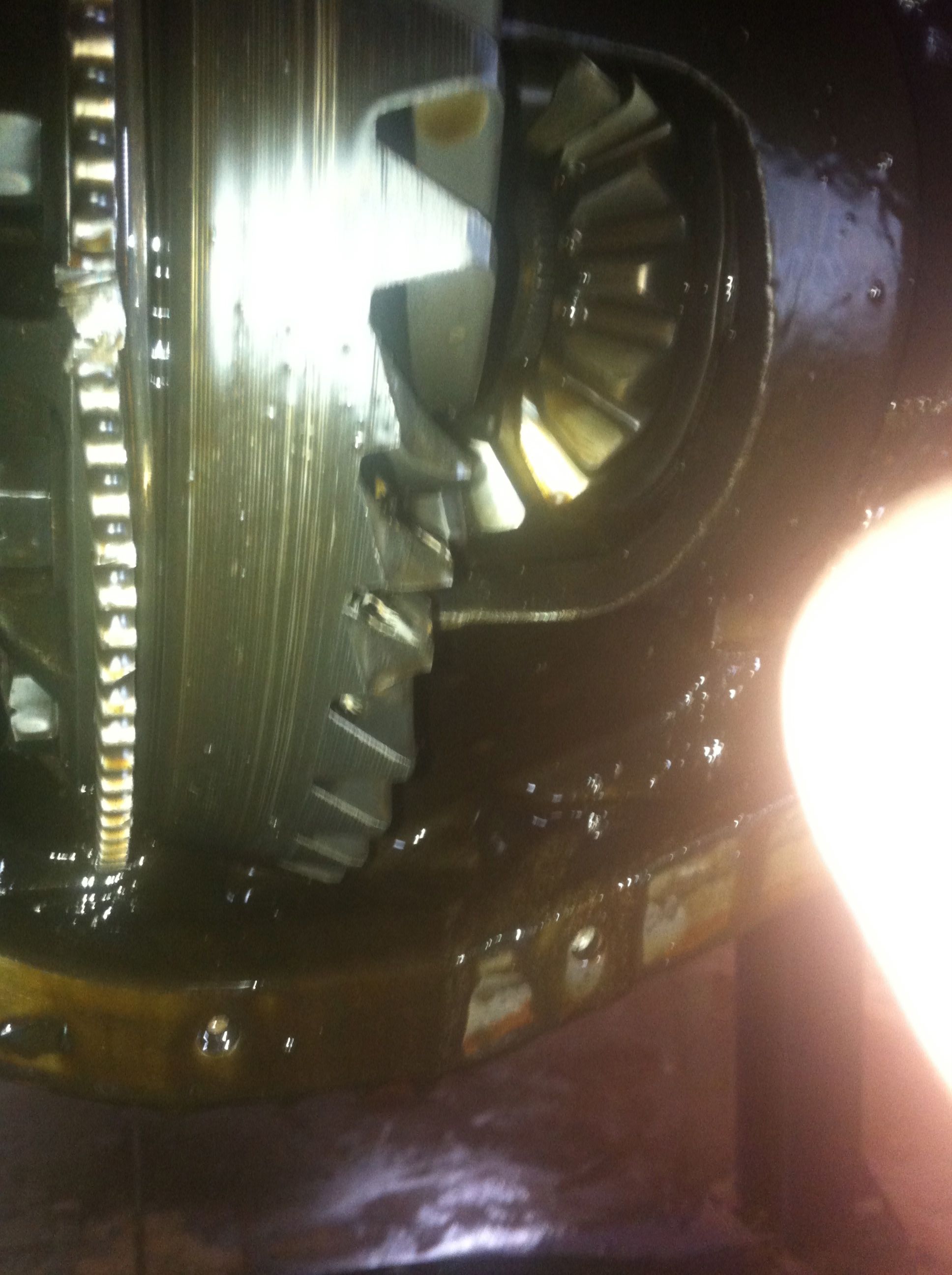

Tore apart the rear end of the drag truck last night to replace the tone ring and found some missing teeth in the ring gear. Cracked on the outer edge in three spots. Wiped out the tone ring and speed sensor. The pinion and spider gears all look good. The differential clutch packs on the passenger side have broken retainer clips and look like they need to be rebuilt. Seems like I remember somebody modifying the stock LSD and added more clutch packs. Im gonna see what i can come up with from Ford.
Looks like I'll be able to get everything cheaper then I had originally expected. Always softens the blow LOL
