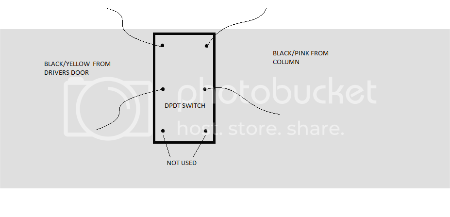

[QUOTE="pnokesjr, post: 795016, member: 12211"] I was looking to stop the dinger from dinging also, when I removed the cowling around the bottom of the ignition and when I slide it down, the black wire with the pink stripe came down from the ignition with a black collar with I metal tab attached. when the tab is touched to the steering column it dings and when it free it does not. so I just zip tied it out of the way. I have an 2002 f 250 super duty does this black wire with pink stripe and collar serve any other function than dinging the door dinger? Any help will help thanks members for your help. [/QUOTE]
