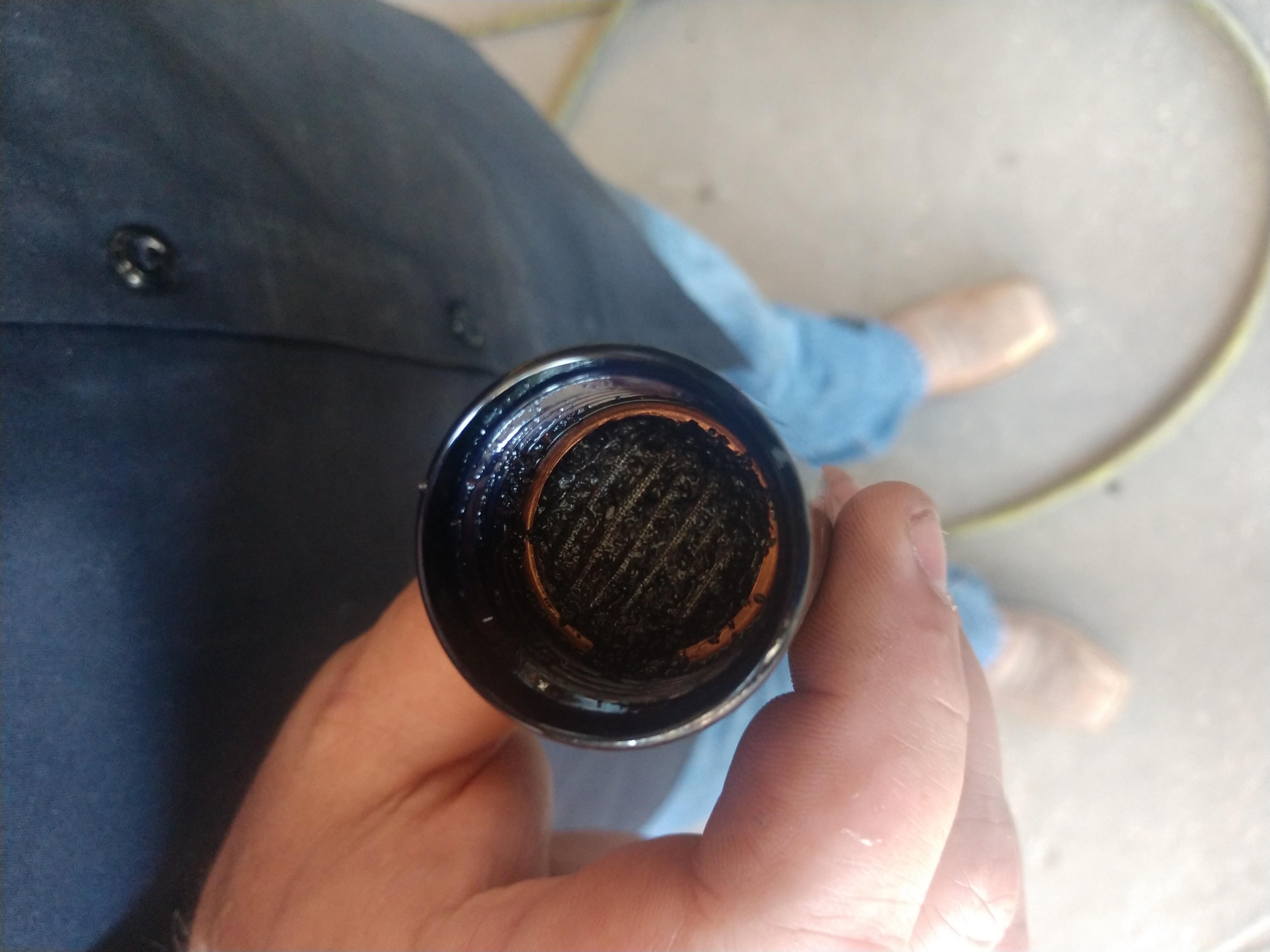

Well fellas...we found the culprit! Both tanks were dropped and cleaned not 6 months ago and they appeared to have been relined. Literally looked brand new inside. However, I don't have a fuel pressure guage inside so we taped the guage to the hood and went for a drive. Idle and normal driving it stayed @65 psi. Full throttle on the other hand it dropped to 0 until I would get out of the skinny pedal.
Went back to the shop and pulled the little screen that is pre filter on this irate system and this is what we found! Plugged with rust. This pic was after he had wiped it a couple times with his finger. Looks like tanks need to be dropped again to see what's going on. Truck runs great for now with a clean screen.

No doubt! I'm sure glad we decided to investigate further before spending that chunk.
