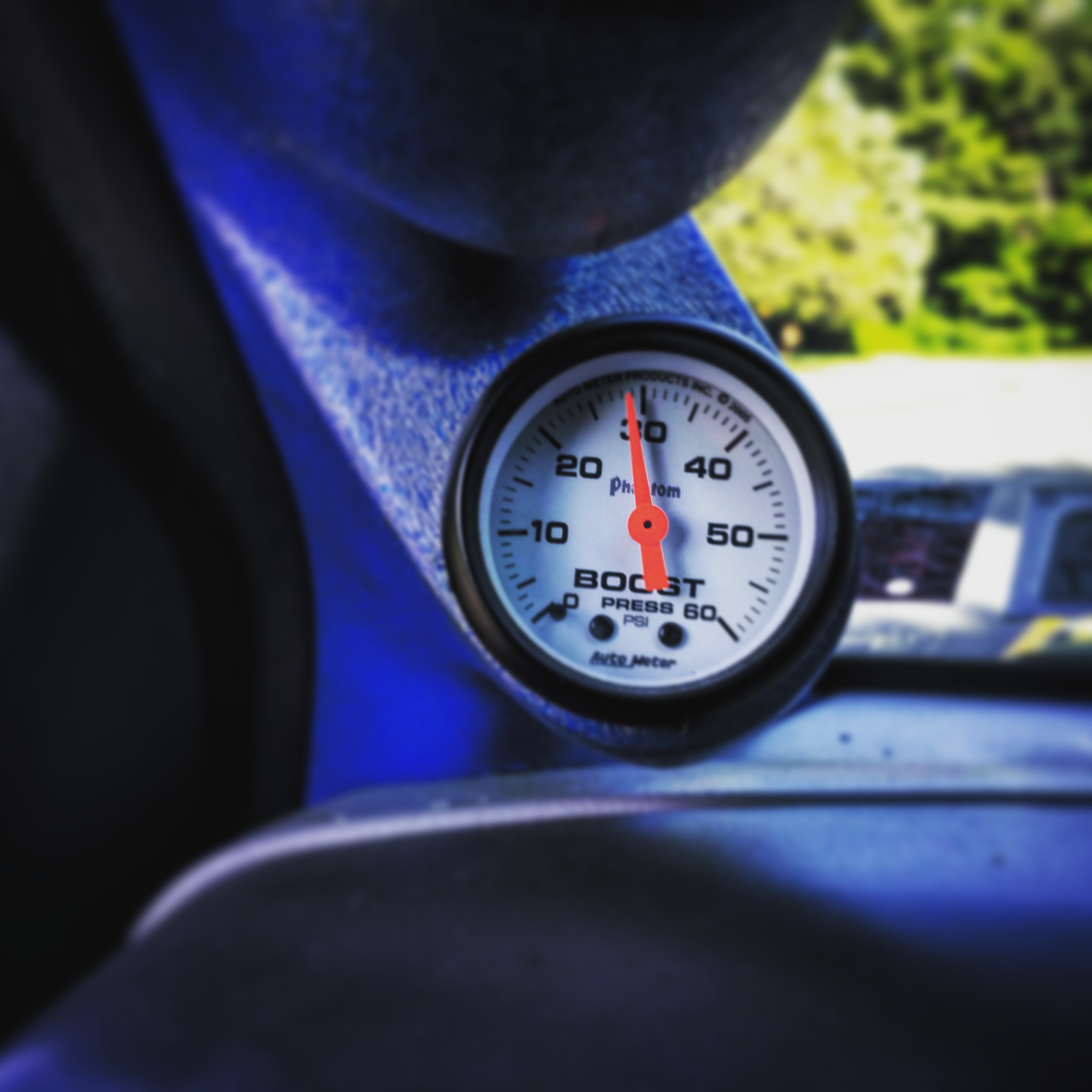

So I've been slowly working on little things here and there for my 01. I've got a 4" turbo back MBRP and I have the EBPV unplugged and open (still physically there, though) and I have removed the intake heater and plugged it with a drain plug from a cummins. At idle, I show 15PSI back pressure on my scan tool, and my MAP is 11-12PSI. At full boost (24-26PSI) I am reading ~47PSI back pressure and ~40PSI MAP. I know turbo efficiency plays a roll in the difference in numbers, but is there any way to drop my drive pressures a couple more pounds and bring it closer to even with my MAP readings? I plan on deleting the EBPV in the near future, as well, as the only reason I left it in there was for engine braking with my old tuner. Thanks in Advance
