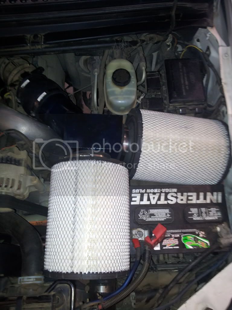

What do yall think

Just so you know, johnathan(bdptuner) at beans took a nasty dirty 6637 and dynoed a truck with it and made 400hp. he then removed the 6637 and dynoed again and ran the same exact numbers... just because the cfm rating scares you as it did me in the begining doesnt mean that the volume of the filter wont be enough... yes i thought the same thing at first then wasted money on numerous cone filters that dusted my intake and started to shine my compressor wheel, i switched back to donaldsons... i have a post on here also about the two bhaf that i did a few weeks ago that goodie got the idea for this.... he is seeimg the same benifits as i did even though one of these filters are good enough for a 7.3, two is better... and yes i like uniqueness myself but if everyone with a 7.3 can benefit from it, why not share it with the world as i did... btw with a 38r you cant hear that sucking noise.I've begun to become a skeptic of the 6637 lately. Mostly for CFMs. Its rated lower than the stock filter, and the loud hissing noise we all are familiar with sounds to me like air being sucked through a restriction.
This dual 6637 would increase CFMs so that would make me a happy camper, but I am thinking about an AIS personally.
But this is pretty neat. I like things that are unique and done just to be unique.
