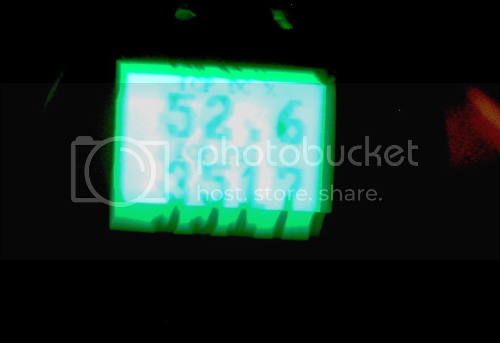

If you've never seen a throttle on throttle off spike in your data logs... You need a new data logger.
***kin period.
Because it's there with stock tuning, on stock injectors.

And just for S&G's...
Here's an adrenaline coming off the line sled pulling, with a 4+ ms of PW tune, on stroked A codes.
Chvyrkr
2,204
Here's a scan gauge with the sample rate turned up, again comin off the line.
And while the only picture I've ever been able to catch shows 35xx, I've seen 36xx on that gauge in spikes.
