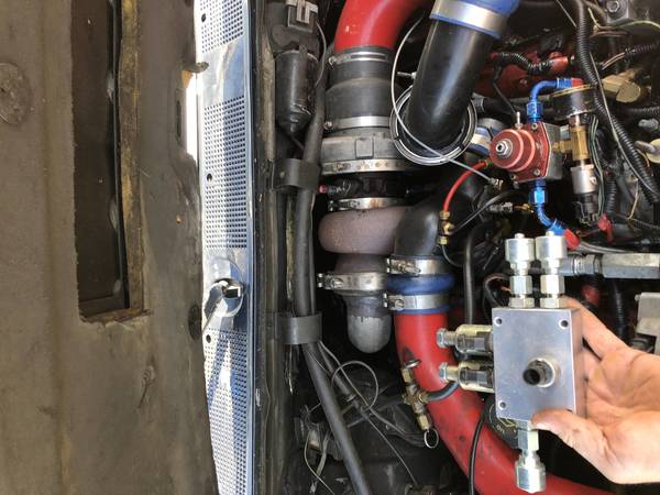

Dual IPR block. Need help

I got the website. I don’t see why I can’t use their Super dooper replacement kit for my needs. Still not sure where to put the bleed off line. My HPOP access bolt cover that came from Dyno proven has an access plug I could maybe use.
It sure where your mounting your ipr block but you could easily drain the excess into a valve cover if you plan to put it in the valley.

Yes I could but, that’s where my turbo drain is and kinda hard to “tap” into that.

I would think a custom plug could be made to go in the original mech fuel pump hole that would combine the turbo drain and hpop oil dump......with little effort. I'll have to double check the size of that hole. What's the original turbo oil drain hole being used for?

the hpop line goes up over the rez level to stop it from draining. you might have to add an early obs-like check valve

Nothing right now but might be hard to get access to it.
Went ahead and ordered that (test) fitting to plug up the stock IPR hole.

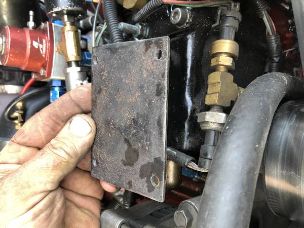

I made my own turbo mount. Got a plug over top of it. No o ring below it though.

Cant decide on where to mount it.
