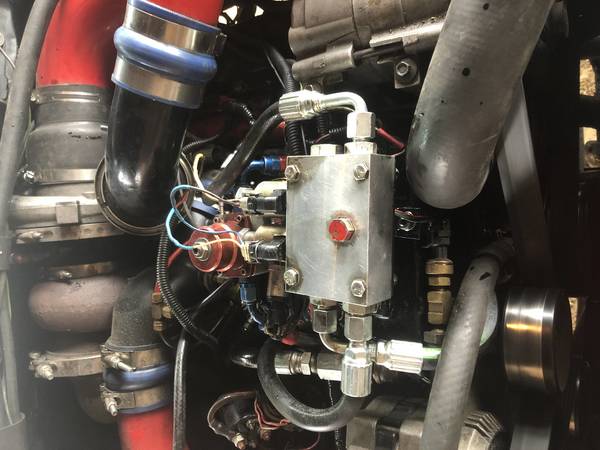

Had some time today, put hoses all on, soldered the IPR wires up, cranked a little bit, and fired up! :redspotdance:
That’s the finished product.

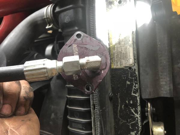

This is where I put the return
Took it up to the block like this
The hose is close to the idler but clears it.

Awesome! Is that hose by the idler, the return? If so, what is the id of the hose?

I kept the ICP where it’s at.
First impressions are, finally no more 3.1% duty cycle. I don’t have the common occurrence of when you let off the pedal and there’s a weird “burp” or “check” that I use to have. Still have a hiccup when accelerating sometimes. Hope that will go away sometime.
One thing to debate is, could the edge filter have been a restriction? Now that it’s not there anymore, could there be a problem? The edge filter kinda acted like a filter to let you know if debris was in the system.

Took it on the interstate. Before, the high rpms would throw the CEL from producing too much HPO.
I still need to figure out what is causing the bucking at high rpms when accelerating. It’s not the IPR now. Maybe the Cam sensor?

Is the cam gear welded to the cam shaft?

After I took the pigtail out of the sensor and put it back in, haven’t had any skips. Might have been moisture?
