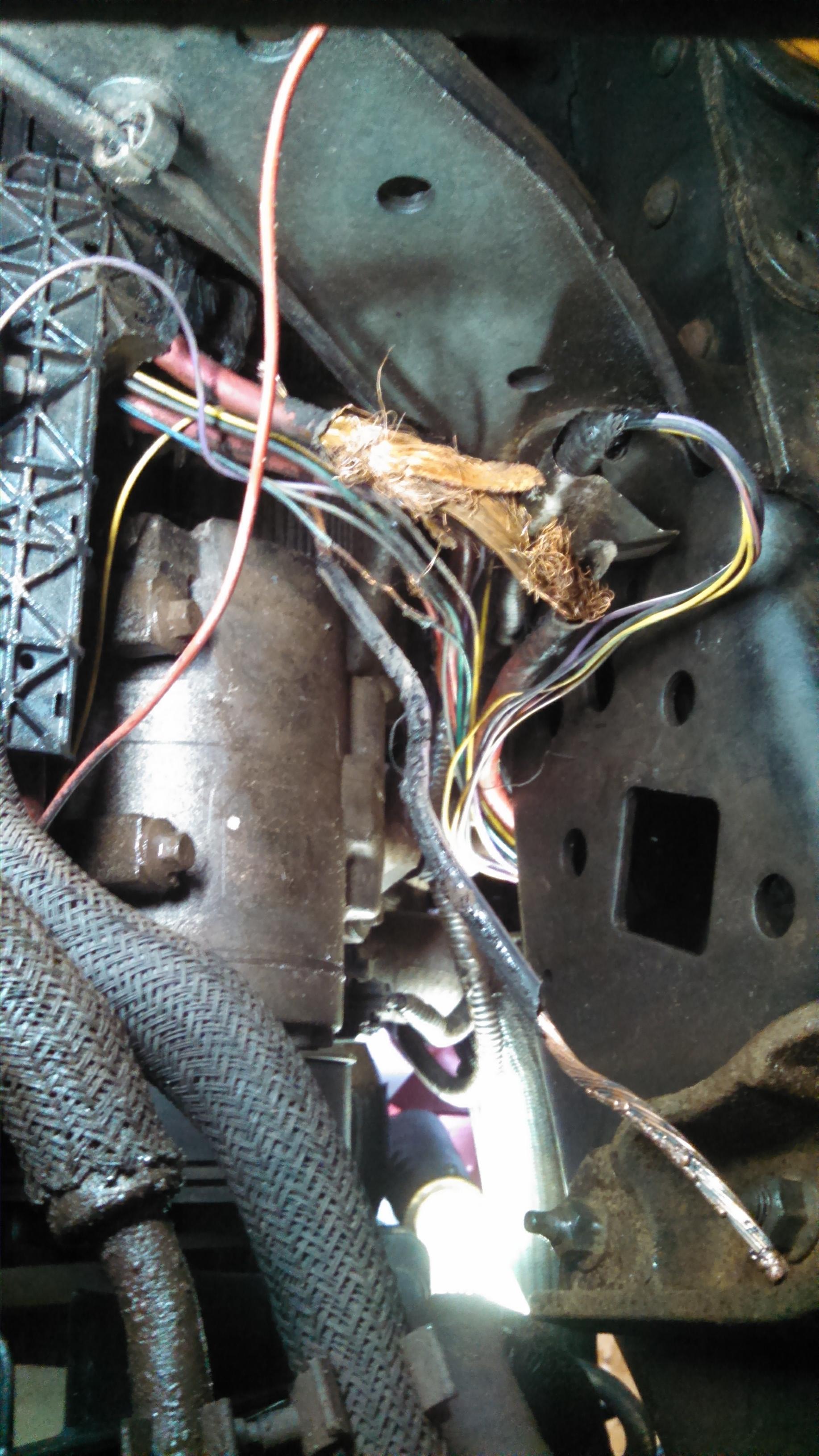

Have a few wires to fix. WTF. Wire harness rubbed through on cross member. I am going to look at my buddies truck to see where his is run tonight.

Round two truck back up and running. No engine lights and seems to be running fine for now. I will keep my fingers crossed. Definitely is a ford problem but they will not except responsibility for the problem. There is a big burn mark in the cross member where the wire was rubbing wile still in there harness and ties.
