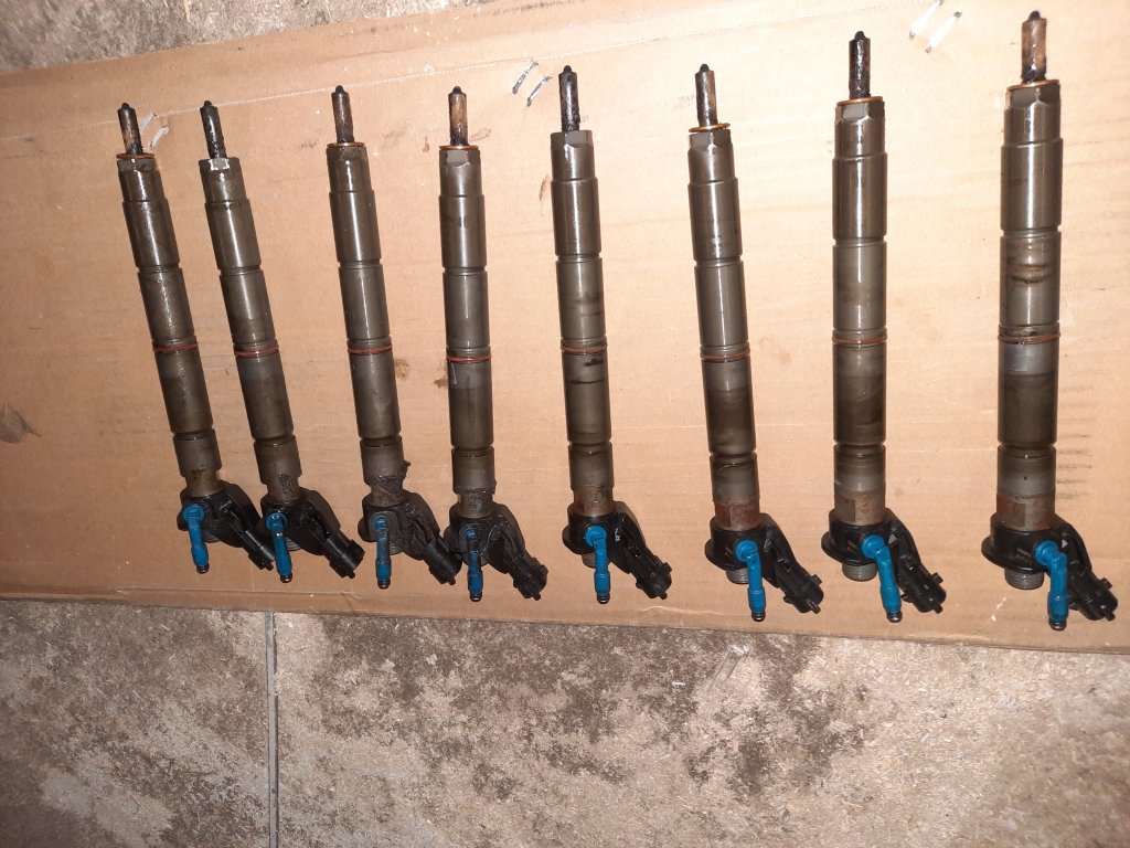

Injectors are out, look better than I expected. Off they go for testing this morning.
I suppose the best I can hope for is to have 3-4 bad ones that bypass enough flow to prevent the rail pressure from climbing.

Okay, Injector test results.
1 failed miserably, IAQ test I think is what he called it. The computer cannot accurately control the injector.
3 more are what he called in the yellow, meaning they are not always responding accurately.
Nothing that would cause a no start condition, so I need a CP4.
He said the injector problems I have would cause smoke, soot, and run ability problems. Which hopefully will cover some of the issues I think I was having.
reusing 4 injectors, installing 4 new ones.
