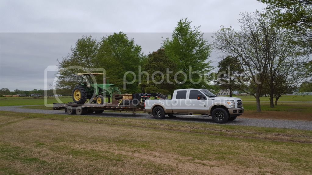

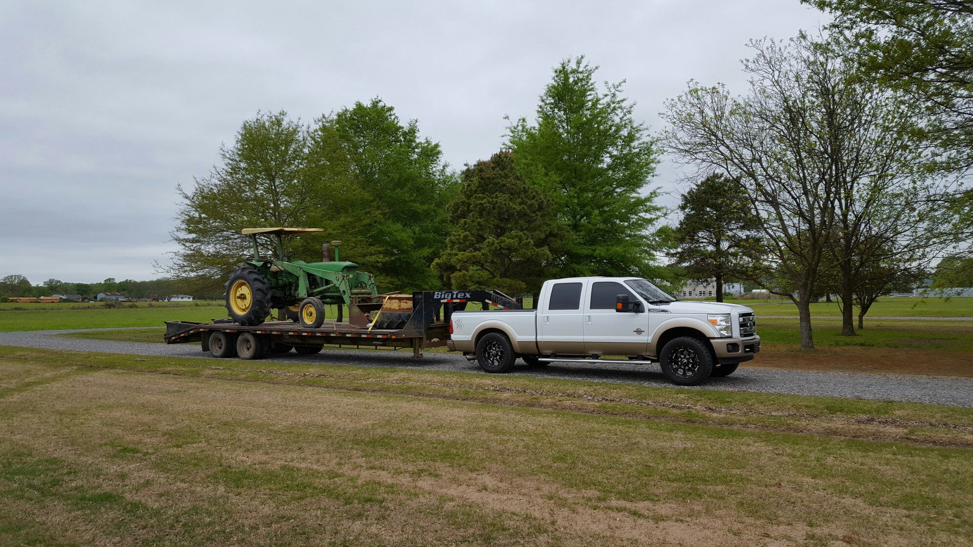

The trailer is grounded through the 7 pin. I even ran a ground from the trailer to the chassis of the truck and verified it at .3 ohms. Dexter brakes and axles all say in the instructions that the trailer must be grounded through the 7 pin and the one I'm dragging is. 20+5 tandem gooseneck "big tex" even my older "hayvan" tandem did the same thing to me.
Interestingly enough I just read up that if the brakes are not 100% adjusted properly it can cause this. However I'm out of town now and cannot troubleshoot this till I get back and am vastly losing interest. (Will probably regain interest when I get back home)

I had brakes half the time.... so I was half safe I guess.... lol. Only blew out one tire. Thank God for tandems.
