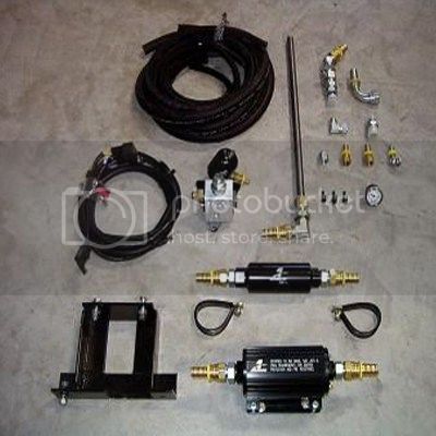

Ever get any pics? Is it the aeromotive setup that is similar to fass and ad or is it a custom built setup with an aero pump?

This is the elite system minus the dahl water separator.

Dahl filter
This is the filter that came with the kit and i had tadd include a custom cooler and bracket.
