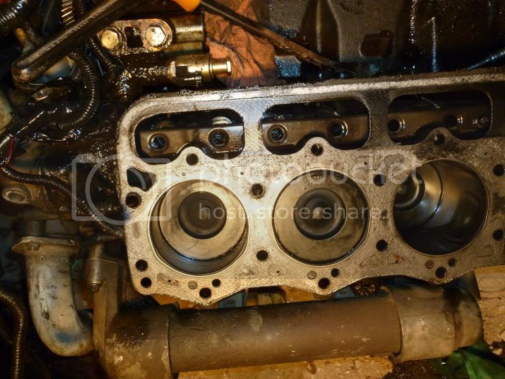

well as many of you may know I blew a head gasket at the end of last year on my pulling truck. As much as I hated to I decided to part the truck out with plans of building a mech 7.3, 3.0 puller instead of staying with a 2.6 puller. it looks like my plans for a 3.0 truck may be delayed a couple years however, because my wife and I are in the middle of buying a house and now it looks like I may have to come up with money to buy a farm after the death of one of our landlords. but anyway enough about me
I started pulling with this engine about 6 years ago when the engine had 200k on it
I pulled for one year with a set of rosewood stage 2s a stock turbo and widman tunes
the next year I got a set of gts 238/200s and an h2e
the next year I decided to go to swamps and got a set of 350/400s and a 74mm bfh and there tuneing
I think I ran those 2 years
then we tried a set of 450/600 and a 80mm bfh
then last year we dyno tuned it and went to a set of 450/400's
the engine now has 220k on it and put down just under 800horse on the dyno
the head gaskets are the original ones I just studded it with h11's

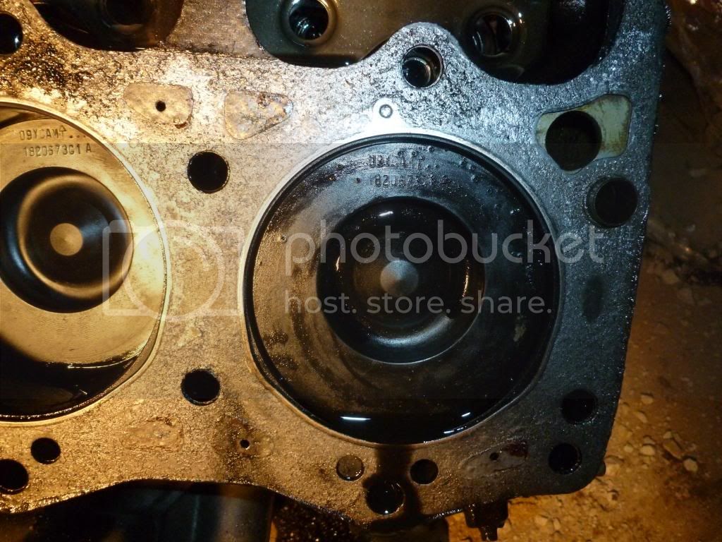

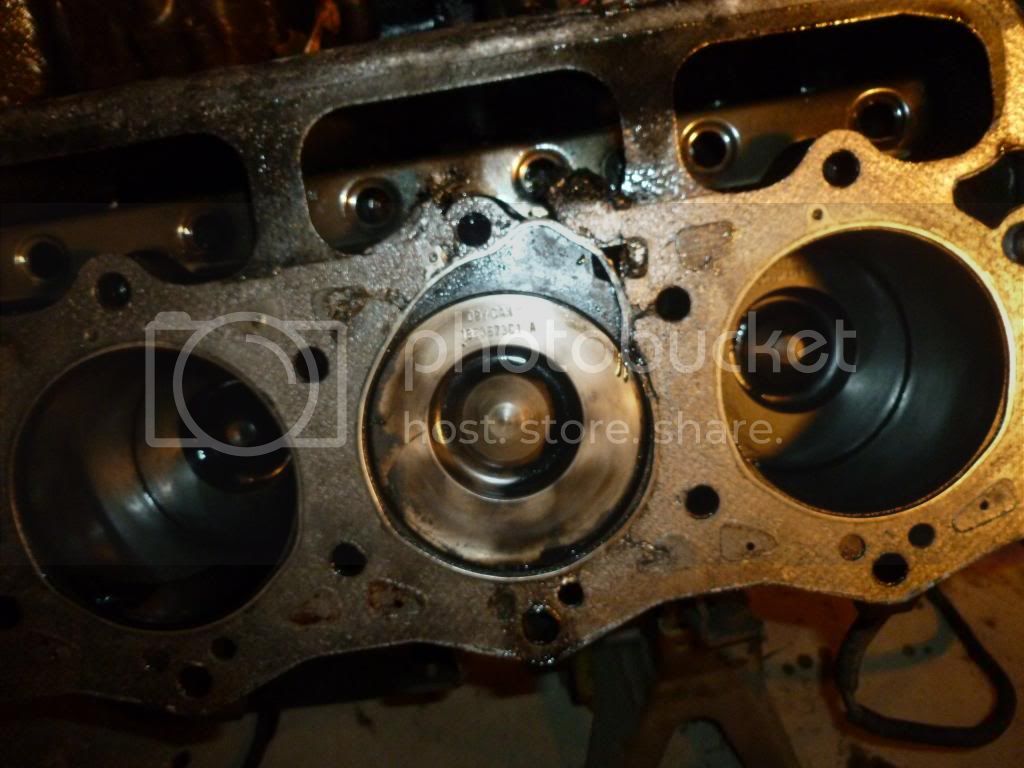

in my opinion this engine looks remarkably well for the abuse it has had. there are a few valve imprints from running a few years with stock springs and tubes and one cylinder looks like it had something get in there and make some marks in the top of the piston, but I have not found a single crack in a piston or any other damage that would make me worried about putting it back together. kind of makes me want to see how much more it will take :evil
