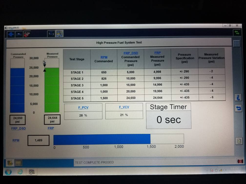

Ill swing by the shop tonight and put the Ids on it and see what happens
Sent from my SM-G950U using Tapatalk
Heavywrecker
Oct 31, 2017
15

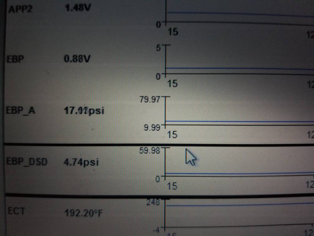

So, fuel system high pressure wise it rite on the ball. Noticed that the exhausst back pressure sensor actual and desired are way out of wack...would this cause my drivsbility issue?
webb06
Aug 14, 2012
3,892
12
Seneca, MO
Ebp-a is absolute. So you must subtract atomospheric pressure. Which is roughly 14 psi. So that puts it right at what desired is asking for.
