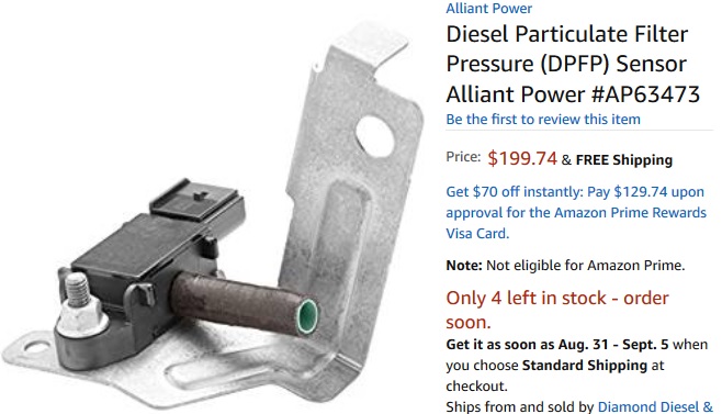

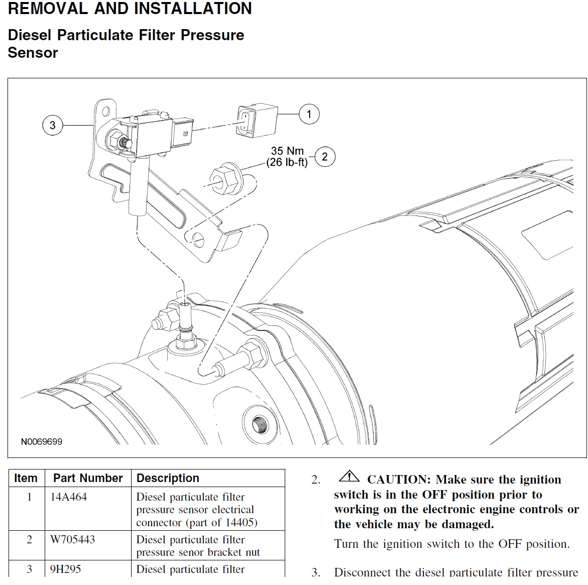

[QUOTE="HossDieselWorks, post: 1517767, member: 20588"] Ahhhh no worries at all. It is usually the bracket (the one in the link) aka the sensor that becomes clogged. You can remove the sensor from the mounting bracket on the ***, remove the short rubber hose from the sensor as well and have a go at cleaning it out with a small pick or paper clip. [/QUOTE]
