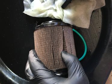

Changed. 17,879 miles. Now have the fabulous buzzing noise after shut down.
Man that looks much better than mine!
I think that piece of oak tree leaf came from swapping tanks for titan. But I always goto the new Wawa stations for fuel. They are all new within last year or two so tanks should be in good shape. And high volume stations too. Not sure why filters would look so dark and dirty. Guess just need to change more often.
I was trying to follow factory recommended interval. My dealer recommended every other oil change. So about 15k. Figured they were just after my money, but apparently they know better than me

Wasn't as bad as I had envisioned. Cheap peace of mind and easy. Buzzing went away after it ran a bit. I must have done the 30 second cycles 15 times before I started it.

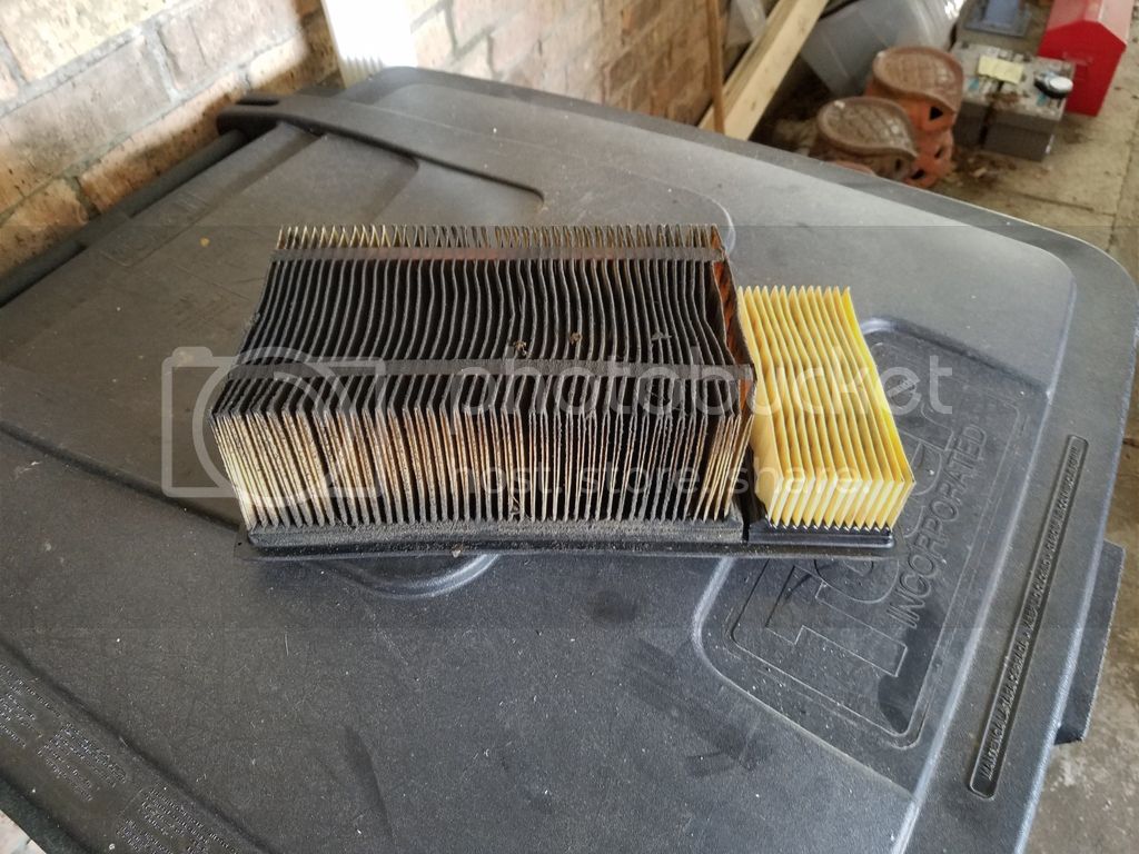

So here is 40k on a fuel filter and air filter... I change filters and oil on my race cars way more then I should, maybe I should step up my game a bit on my daily.
Yeah, I'd change more often lol. I go 10k with fuel filters. They're cheap insurance.

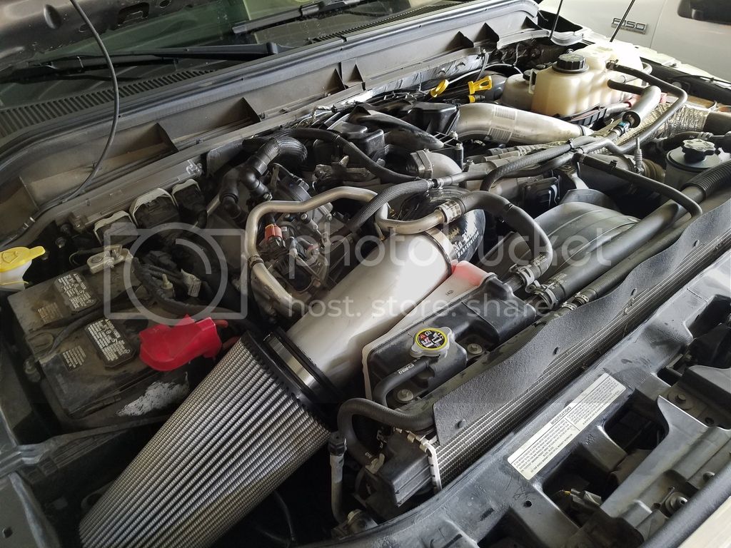

Kind of a strange looking air filter for a stage 1 intake.... Maybe the carpet doesn't match the drapes. :lookaround: Probably a good idea to change the filters sooner like Jomax said.
I was putting on the stage 1 intake when I took that picture.:D
