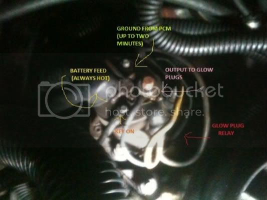

Once we got back to the shop I had him pop his hood and located the GPR (farthest one back passenger side of the motor)
after a quick "google" and a second with the test light to make sure i figured out what each post does on the GPR

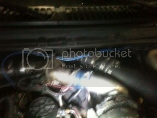

I than ran a wire from the "pink" post which is the output to the glow plugs to the cab where i wanted to mount the LED. You will need a 10mm socket to get the nut loose and an eyelet connection
I chose the a pillar for both his truck and mine as we have gauge pods. I simply fallowed the boost line with a few loose zip ties.
I then drilled a 5/16" hole in the pod, connected the wire off the GPR to the positive side of the LED and ran a ground right behind the a pillar on a bolt, pushed the LED in place, threw the gauge pod back up and tested it.
