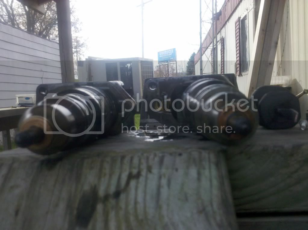

I swapped two injectors last fall hoping some things would follow and no luck, but I did take a pic of the 2 while I had them out.

Golfer sorry your right I just re-read my first post and I never really did ask a question. I guess what I really need to know is what would cause bad/barely running in the fall and come spring other than the smoke its running fine. The smoke mainly only happens like a light haze at idle and a good puff on take off. The exhaust even before the running problem had a slightly stronger hint of raw fuel smell. It just kills me that when we had it on the Solus it passed the buzz and contribution tests just fine. This things just got me flustered.
JL is doesnt show any of the other typical signs of cracked cups.

The solus basically told you the connection is good through the buzz test. Imho the only true way to tell if a Injector is bad is having it flowed. Reason I say that is because we put a solid on a 6.0 and it had all the signs of the bad Injector. Run it down the highway and none of the parameters were undeseriable. Take out the suspected bad Injector...and long and behold switching the Injector fixed the issue.
jmho
