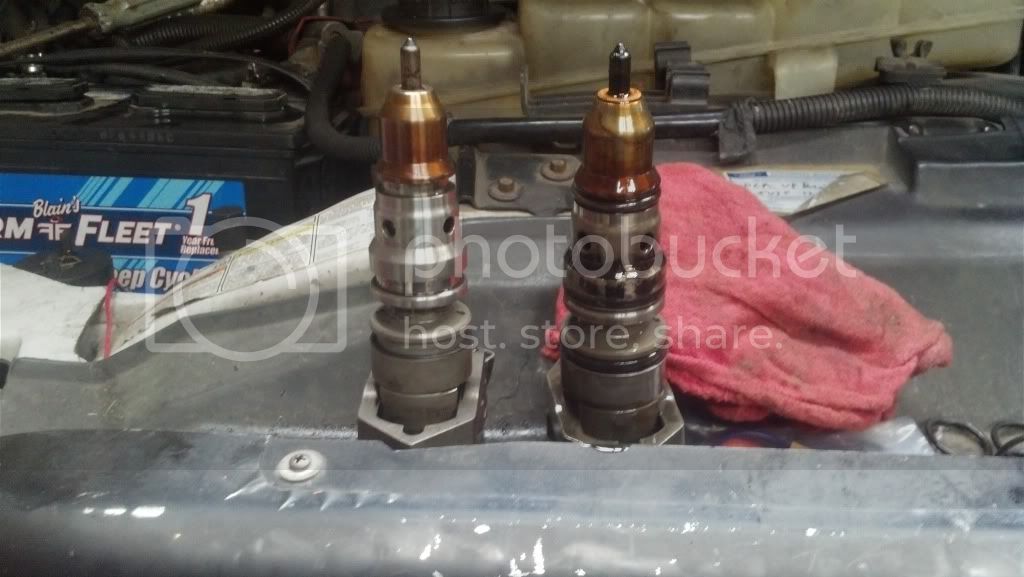

Well, had to bring it back home. The temp in the shop was between 70 and 80* when I pulled it out to load it up. Fired right up and didnt smoke to bad, took a little bit to load so it got warmed up. About an 1hr-1 1/2hr on the trailer ride home with a temp in the mid 30's. Fired it up, wasnt running as good and by the time I got it parked it couldnt move it self. Didnt get anywhere near warm this time. Well just before that I was chatting with POWER-STRUCK for quite awhile discussing the problem. Im really leaning toward injector problem, specifically the poppet valves. Unfortunately where I have it now is not heated and its been extremely cold. And with me thinking these are the original injectors, unless someone can come up with anything that hasnt been tested. Im gonna go that direction. I really need to get the truck going!
