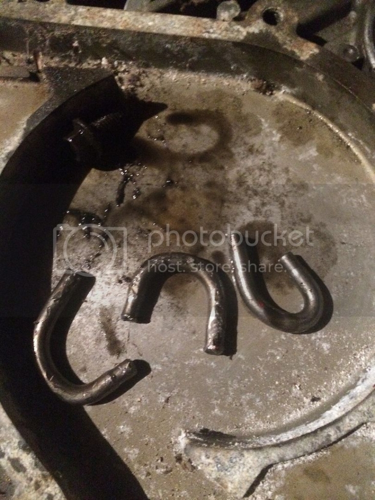

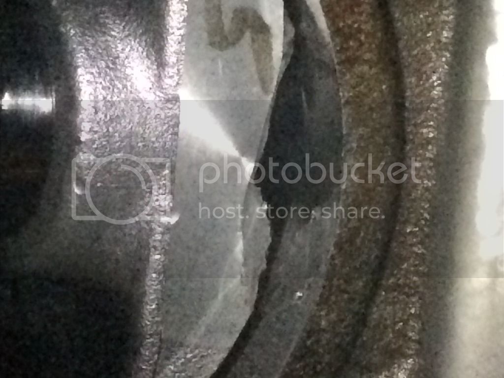

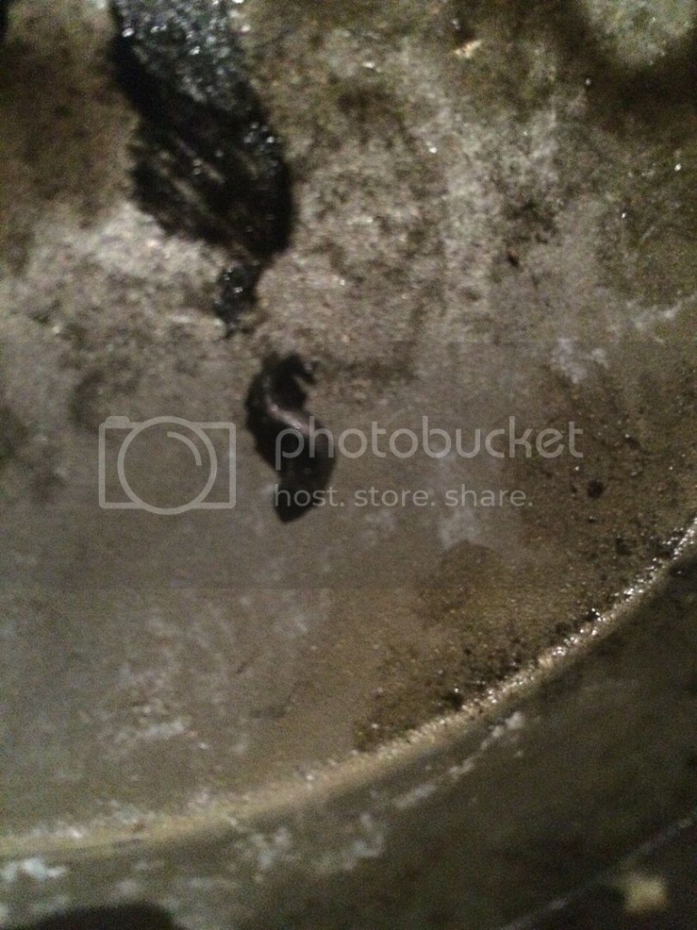

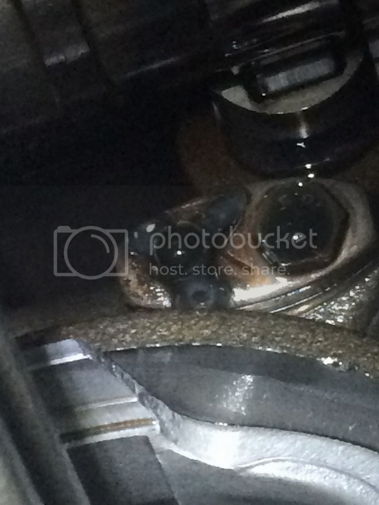

Couple pics
What's left on one broken spout
The broken spouts
Something is hitting them

This is one piece I found. It's magnetic, so not apart of the piston or front cover. Must be apart of the oil spout

The chipped piston still has me worried.
I'll take glowplug out, put on engine stand, and do compression test and and inspect oilers. Really don't want to take girdle out and inspect bearings.

Why is this a big deal? I'd assume the jets are soft metal and didn't fragment when hit by the connecting rods? The rods themselves are forged, that should be no different than hitting a nail with a hammer. You don't worry about damaging the hammer when that happens. Maybe I'm out to lunch, but the only thing I'd be worried about is where that chunk of piston went. Are there dents in the bottom of your pan from con rod to jet contact? Again, if not it's a moot point. Just my opinion fwiw.

Pretty much. While the engine is on its head, you might pull the caps and inspect the bearings. Itll be immediately obvious if any material went through them.
Sounds like you paid a shop to assemble this? They should have rolled the engine, before they put the pan on. I'd have them fix it, including a piston, if required.
