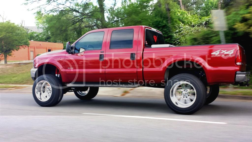

My insurance company helped me out greatly by avoiding a total loss and salvage buy back situation. Anyways just sharing some pics of it since I got it back together about two months ago now.

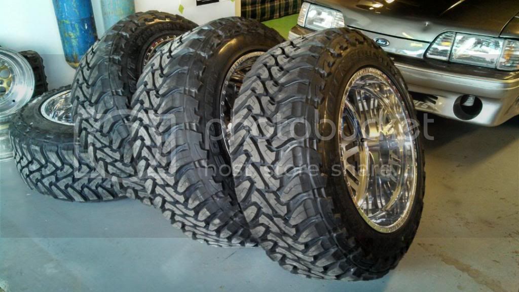

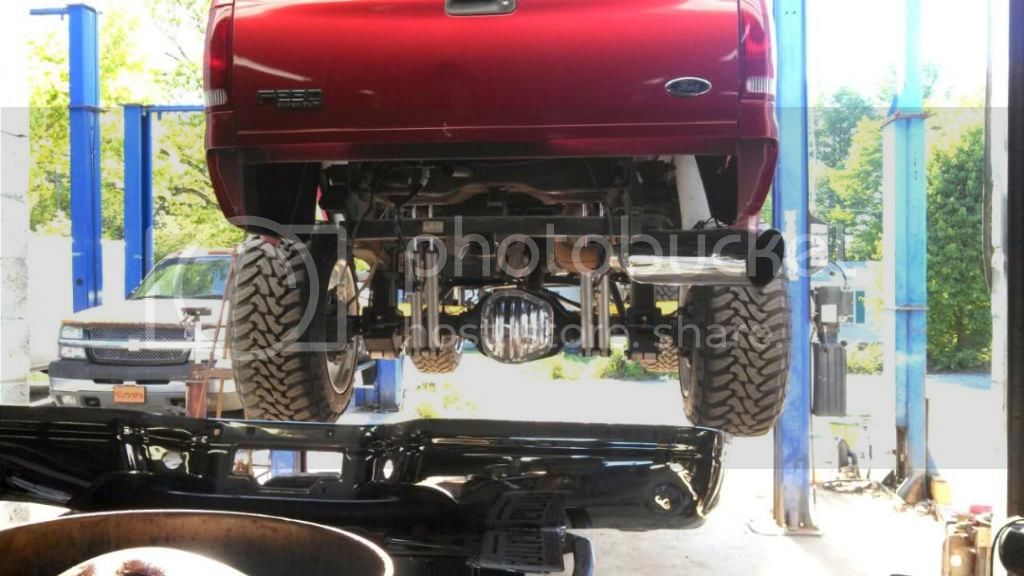

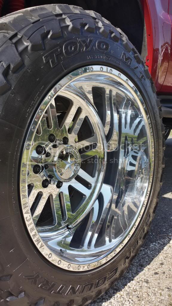

I took off the blocks in the front and changed the springs to factory X codes to raise the Icon 4.5" spring hanger kit to approximately 7". Ditched the old 4" + 2" stacked rear block setup and replaced with PMF 6.5" rear blocks with 2.5* taper and traction bar mounts with their matching bars all powder coated black. Redhead steering gearbox. Randy's 4.30 gears. American Force Rebel 8 22X14 with Toyo MT 37X13.50. 8" X 28" tip

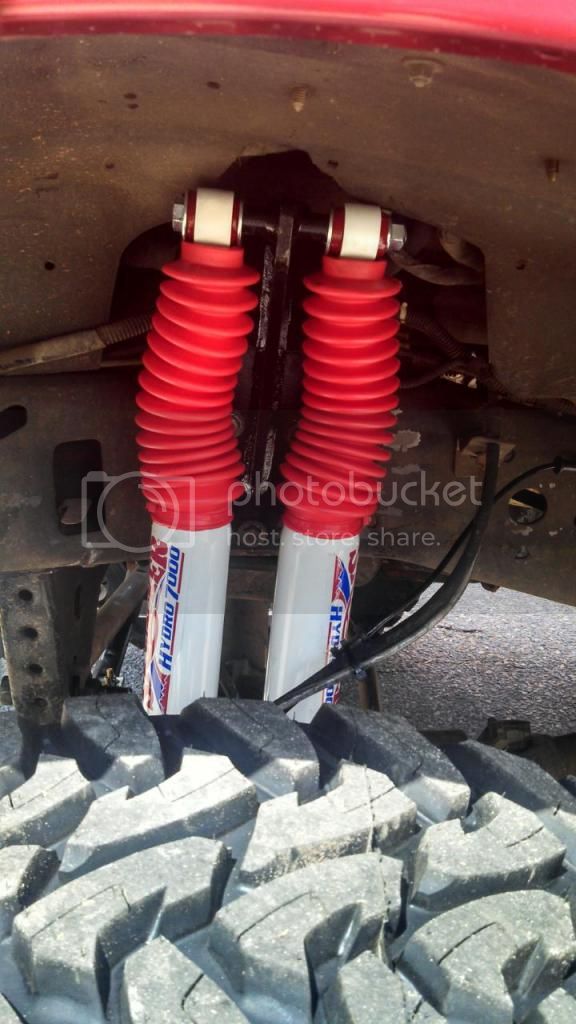

I started running out of money on shocks so I bought the cheapest dual stuff. Rough country front stabilizers and rear shocks, skyjacker front shocks. It rides kinda rough but I don't drive it that much so I can live with it for a little while.
