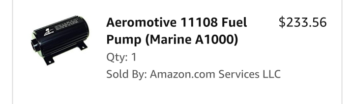

I built my own fuel system with an Aeromotive A1000 marine pump and bought the fuel lines from Swamps. The filter heads are just generic with Napa filters. It saved me bookoo bucks. If I was going to do this on a newer truck and had over a grand to lay out for the project I'd go with a Fass Signature series. You can't beat Fass for quality IMHO.

Yeah I checked out the fuel systems they are pretty spendy the basic one is 675 plus parts and harness, and it's only 67gph, does anyone know what the stock pump runs gph? Also looked at the regulated return and its compression fittings[emoji17], Im Not a fan of compression as guys at work will find a drip and then over tighten and then it leaks more and boom your fabing a new line to replace the one they wrecked. So I'll probably just make my own as I'm kinda a snob on hardlines. Looked at the a1000 pump for marine applications and it does 105gph will see if I can find a cheap one will probably run cat separator and filter as we had good luck with them at work.

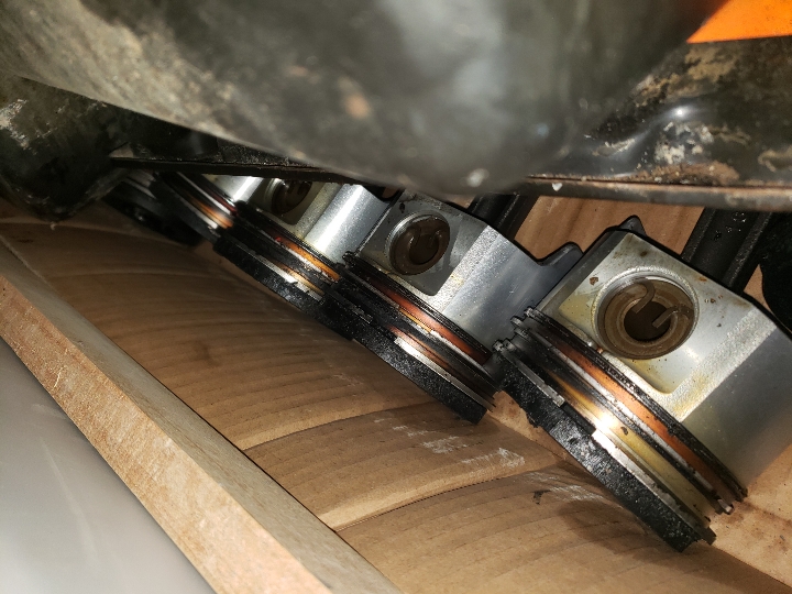

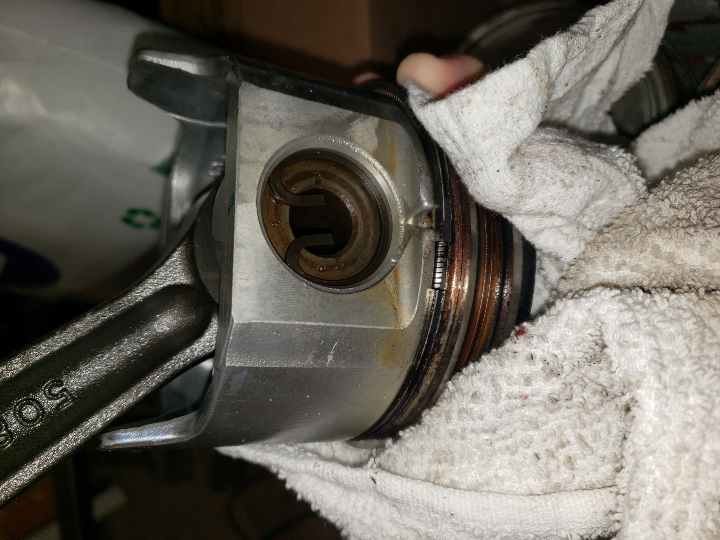

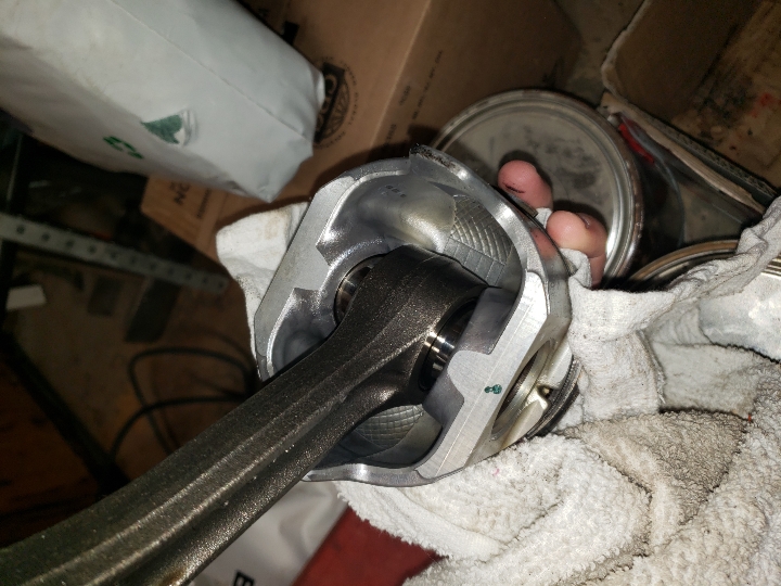

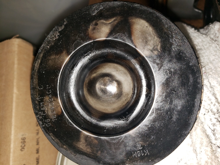

Here is some pics of the ones I can get too
Sent from my SM-N960U using Tapatalk
Those dont look particularly cooked, so maybe just a lot of time at high rpms.
As far as fuel systems, if you are mechanically inclined, they aren't difficult to build, even with dual stock pumps.
I think I had around 750 into the last fuel system i built, and that was tank to engine, using strictly diesels regulated return on top of the engine.
Big Red Bus
Jan 5, 2020
20
The bakken ND
Yeah I have built engines before and worked on diesel engines mainly cat 3512's and 3304's no my way around them and I think I will build my own system and probably my own regulated return. Hope to get it to the machine shop by end of this month. I hope the heads check out to keep the price down on the machining side.

Have you had any problems with the a1000 marine pump I bought one but it read on their site that they are not for diesel, I called and at first they said it is fine and then he put me on hold to talk to a senior tech. And he said it is not recommended because it needs to be brushless motor? Kinda think they are trying to push there diesel pump/filter combo for over 1000 dollars

I put the red A1000 on the very first fuel system I ever built. That fuel system is 6 years old and has 60,??? miles on it. Zero issues. I think you’ll be just fine.

Sweet I would assume so the only difference that he told me was that it's a brushless motor for the diesel one but that shouldn't matter for pump design it's just not gonna be as efficient and not as much power as the brushless if the pump design is the same.
