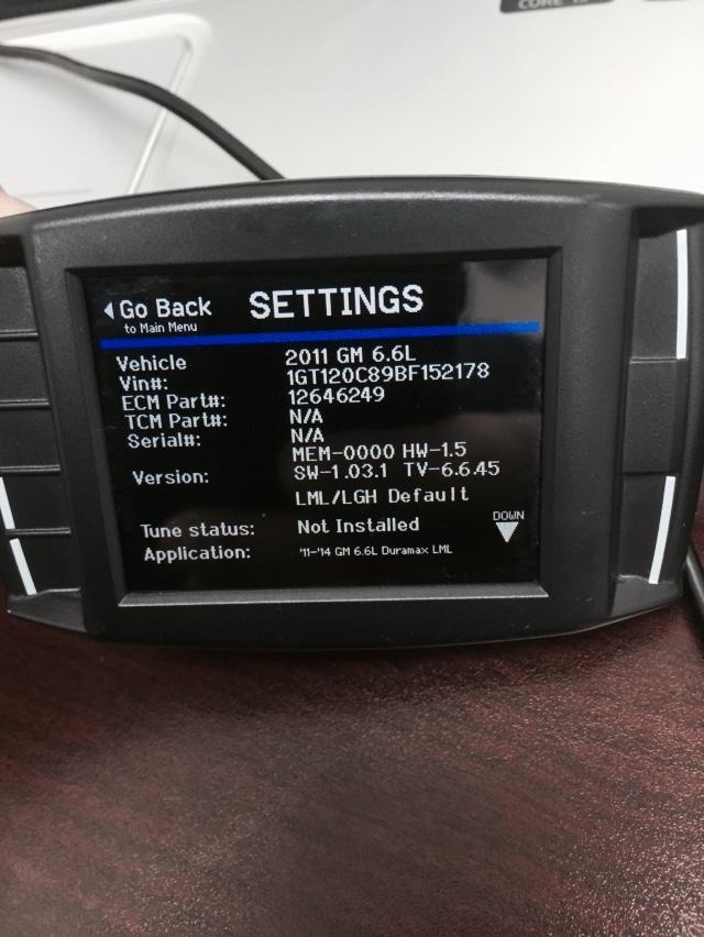

Just post a pic of the show settings screen

I told the guy to send me a pic of the screen show settings. Said he will later today after work. I'll upload it as soon as I get it.
Here it is guys. Pic of the screen settings. What do yall think? Good to go? I have a 2012 f250

its an original race tuner from what i can see. you will need an unlock code form Mike to tune your truck with it.

1.0.3.1 = street tuner = works on up to 14 Ford with no 6.7 unlock code necessary
serial # NA = international street tuner = it's the one you want!
