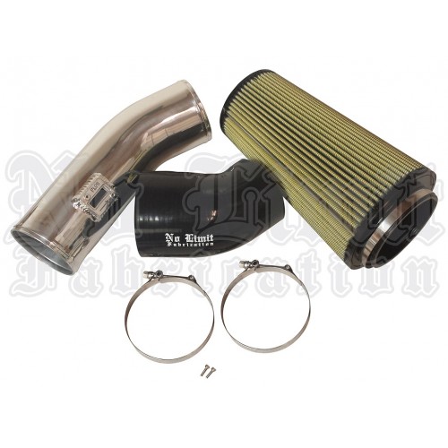

Reuse the OEM clamp.
You should have two metal tubes from NL.
#1 clamp: Secure the air filter to #1 tube.
#2 clamp secure the NL boot to #1 tube
#3 clamp secure the #1 tube and NL boot to #2 tube.
Then the smaller NL boot will connect the whole thing to the turbo. You should have one more clamp plus the OEM clamp.
