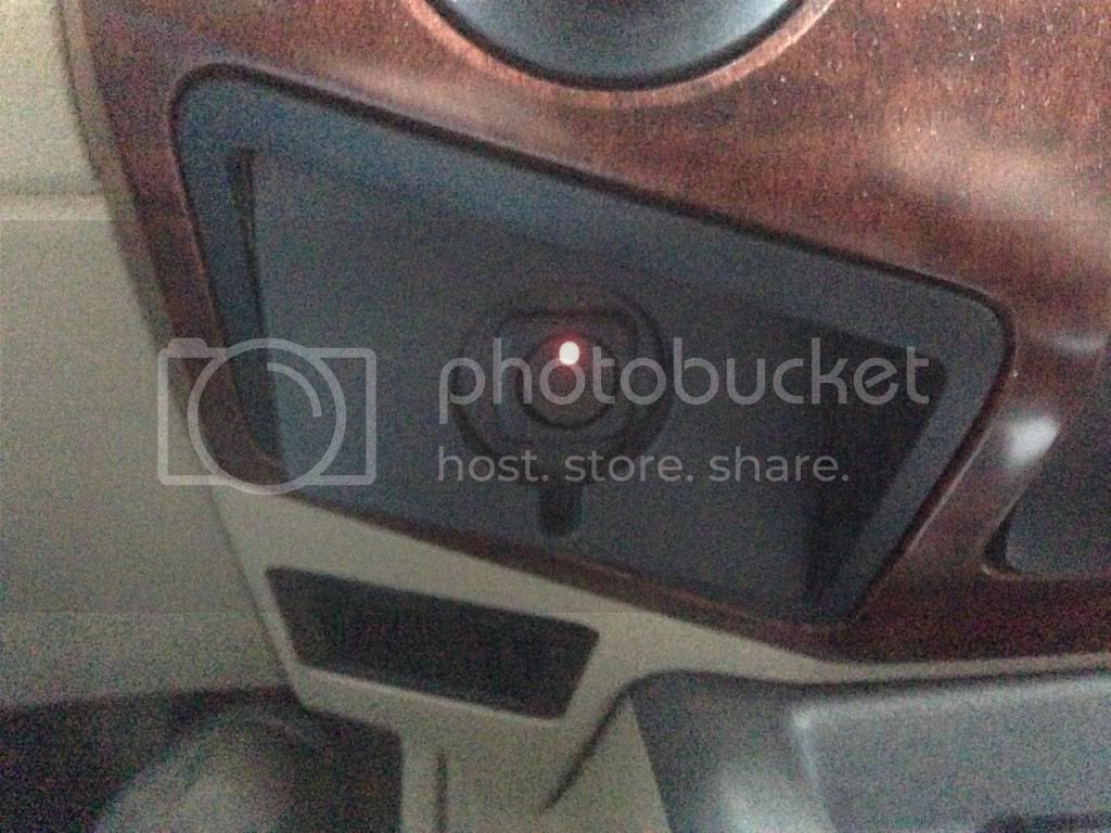

I finially got mine all wired up with an extra rocker switch. I jumped power from fuse 52 under the hood so it comes on with my remote start. Then just used the wiring info on this thread. Here is where I put my switch. I took out one of the 12v power ports and put it in there.
