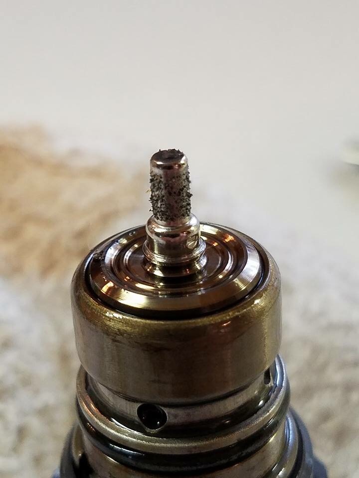

Good news! No rust!
Only clean metal

Dunno for sure. Going to start with cutting filters open and go from there.
I put a sump in it and had half the tank in buckets and the fuel was clean. So there's not much if any making it down the return side.
I mean the truck runs fine, holds 31.5k no problem and made 976 hp two weeks ago lol.

Yeah I'd have to take the hpfp apart to see if it is actually failing.
I'm going to go through my pre pump strainer and frame mounted filter tomorrow. If I find any more metal it's all coming apart and I'll pinpoint the failure.

It definitely makes sense that the metal debris on/in the PCV was causing it to stick and thus creating the higher-than-commanded rail pressure situation. I just wonder what started the sequence of events that caused your issues. The high rail pressure could be the reason why your fuel was getting so hot, right? If your HPFP was starting to go, I'm sure hot fuel wouldn't help matters. I'm very curious to find out where the metal came from. Also, it would be interesting to see if your fuel temps come way down once the fuel system is cleaned up. The sucky part is that I've never heard of anyone having luck flushing the high pressure system on a 6.7. I work for a dealer, and I know our shop only handles contamination issues one way: every single component gets replaced. That's bad enough news on a stock truck without dual fuelers, hot injectors, etc. Like I said, I'm just curious to see where this all started. Best of luck to you with getting it resolved.

Higher than commanded Rail pressure didn't help, but it's also my fuel pump setup that contributes to the hot fuel.
If I find anymore contamination all the high pressure lines and rails will be replaced, I'll sending the injectors out to asses the damage and replace the cp4 with a stock cp4.2. The cp3 should be fine.
