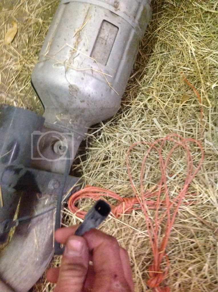

Here ya go these are from when I took mine off. I wrapped them now and put dielectric grease in them.
I got more they're uploading.
