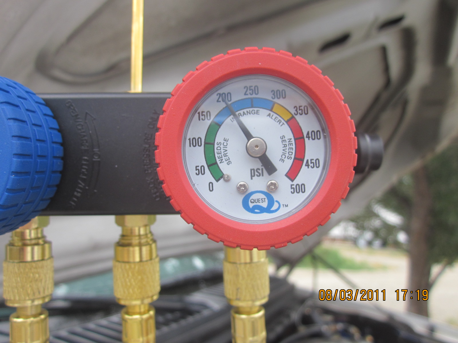

Got some gauges...
Took some readings...
Added 12oz, didnt come up much. Going back to Auto Zone to buy a big can...
It was at the low end of where it should be... At least as far as I can tell.

Ok, added another 18 oz... Now its up to about 35psi on the low side and 220 or so on the high side...

Plus, if you look at his pressures on like page 4, it was 95* out and he's barely making 200 psi high side.. if it was an R12 system he'd be good, but and R134a setup at that ambient, he should be 225-250 for a crammed-in-with-a-stick full charge.
