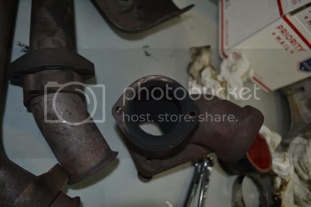

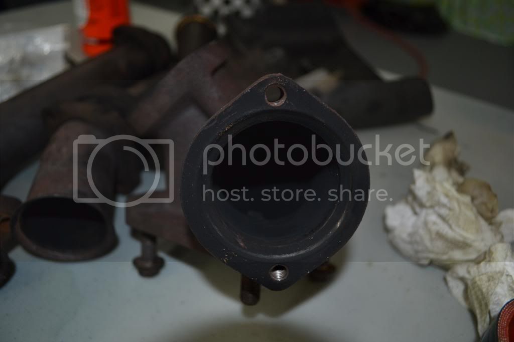

O.p. Just incase you don't understand, you CANNOT use your e99 up pipes with the l99-03 turbo/pedestal. You would have to use late 99-2003 up pipes.
RattlinFord
Feb 1, 2015
106
Wetumpka, AL
That's what I originally thought...but then he mentioned brass donuts and I started thinking...and craving donuts. It's ok, I'm keeping my stock turbo...
