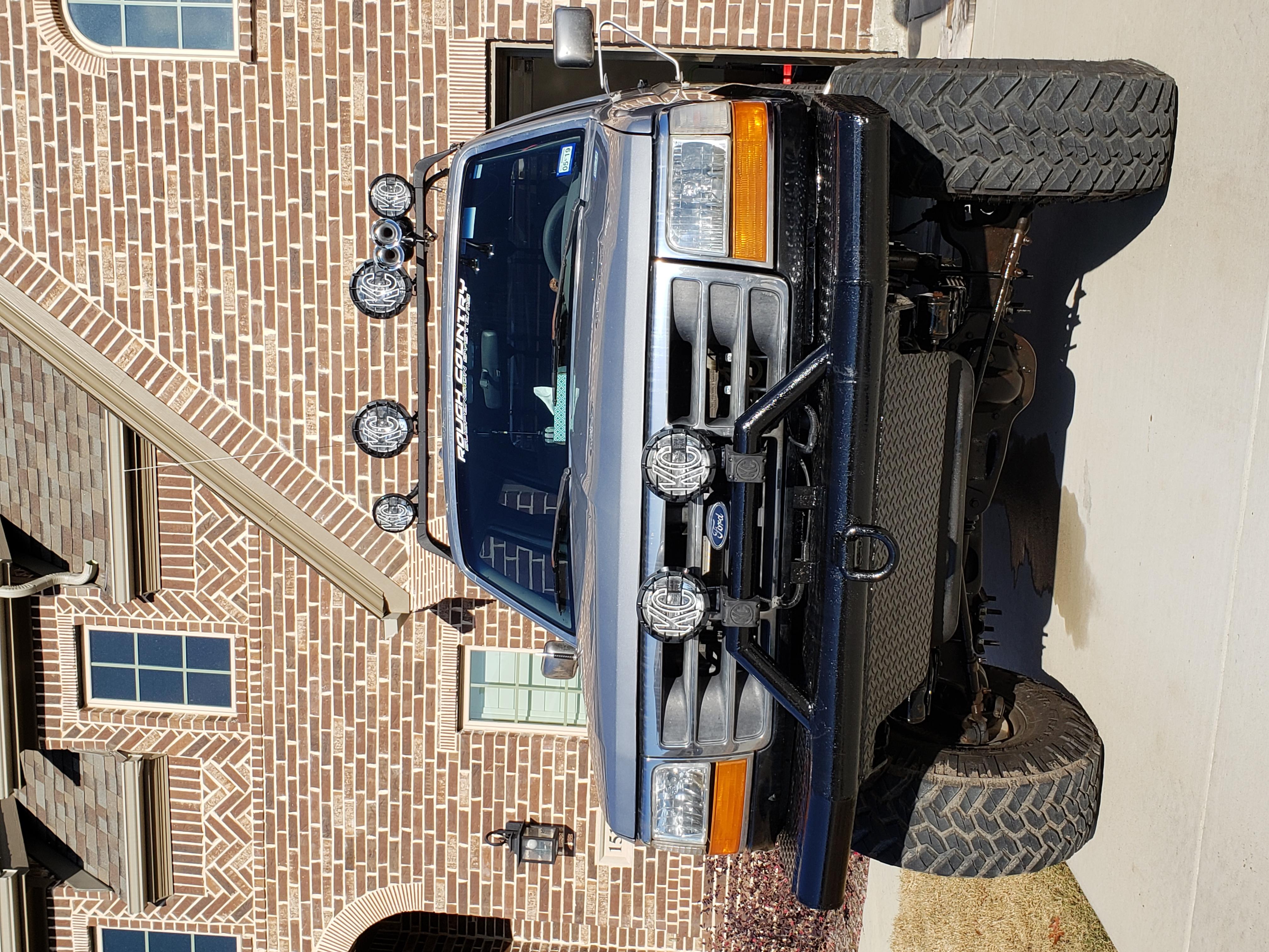

Ideas for mounting winch
[QUOTE="DarcyB, post: 1531654, member: 24888"] That's what I was gonna offer, as a rule of thumb use your gvwr multiply by 1.5 and that should be minimum size winch to run. With the design of bumper you have I'd do a receiver style mount as well just below the bumper tubing back to the frame and add some bracing if needed. Sent from my XP7700 using Tapatalk [/QUOTE]
