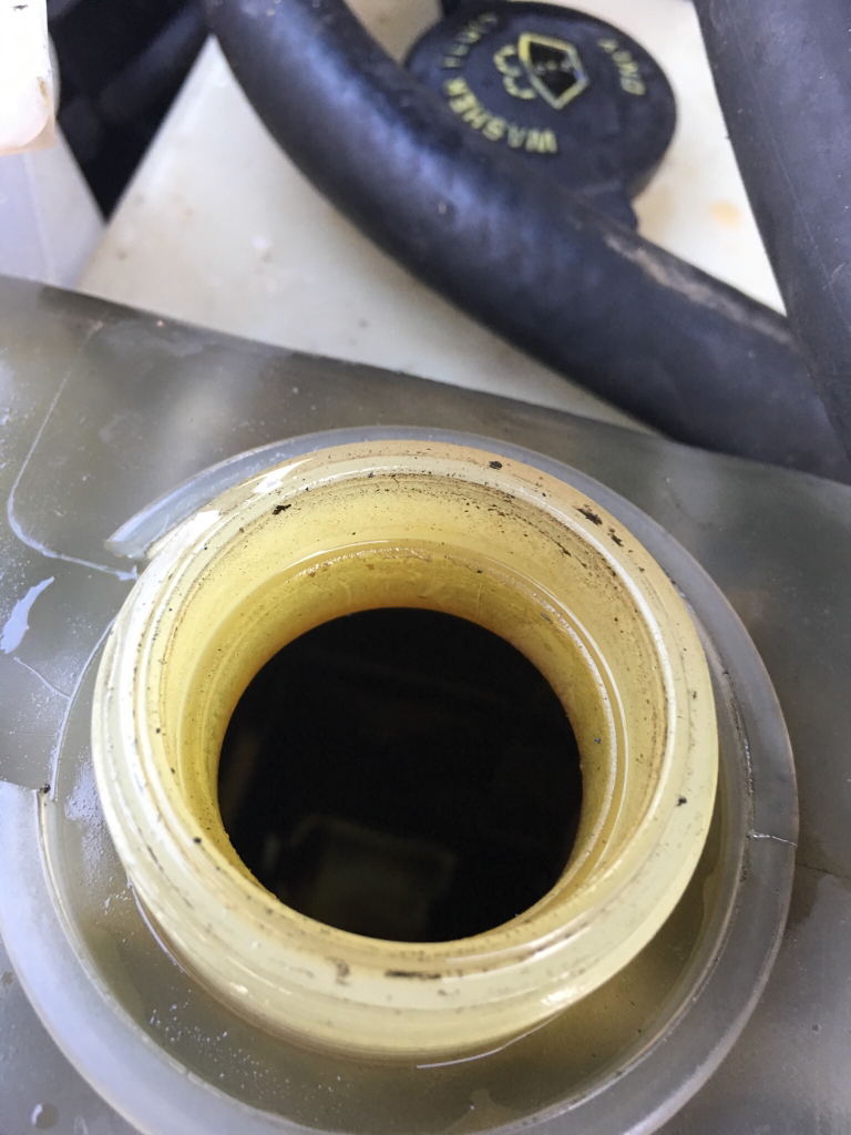

The coolant is black. Injector cup?

Pull the injectors and add shop air to the degas bottle to around 15 psi or so (have a helper wrap a rag around a blow gun and press tight to the bottle opening) and watch in each injector bore. If you don't see any coolant or hear any hissing then it's not the sleeves.
But I can't believe a head gasket would blow at 30 psi. I had my stock head bolts/gaskets hold several runs over 50 psi.

Ran a compression test. All but one cylinder was between 300-320 with a cheapy harbor freight gauge. Oil pan level is way up and degas bottle is empty. Pulled the injector from the cylinder with zero compression and it looked like the cup was full of coolant. Could have just been the oil/coolant mix from pulling the injector since I didnt drain the rails. Cracked cup pour coolant into the pan?

Shop air in the degas comes pouring out the injector open that had no compression

Pulled the cup. No cracks and was in the head quite firmly.

Cracked block, cracked head or blown head gasket. Cracked head ive never saw before on a 7.3 but ive heard they can crack inside. Cracked cylinder wall.
