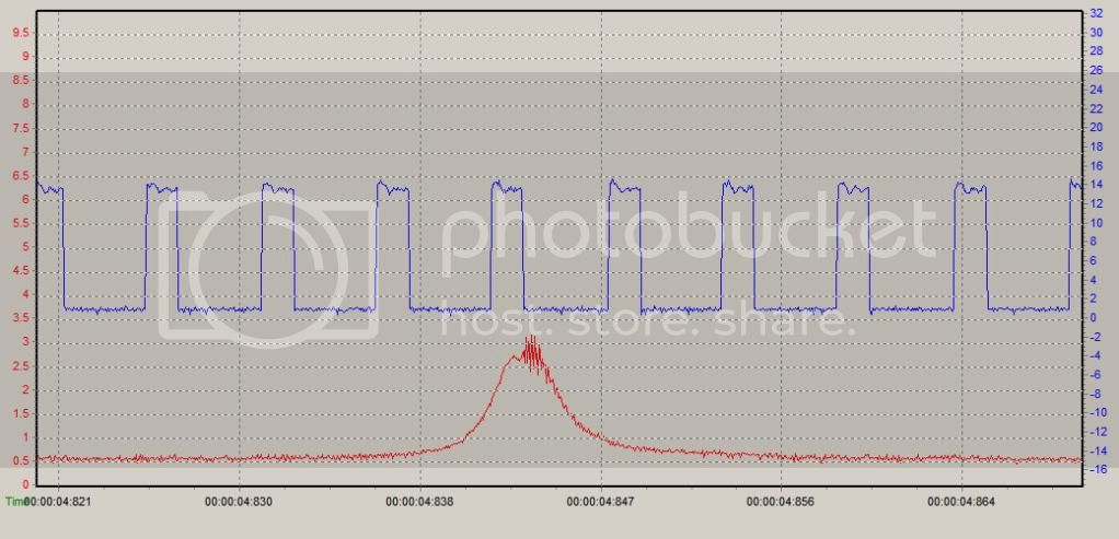

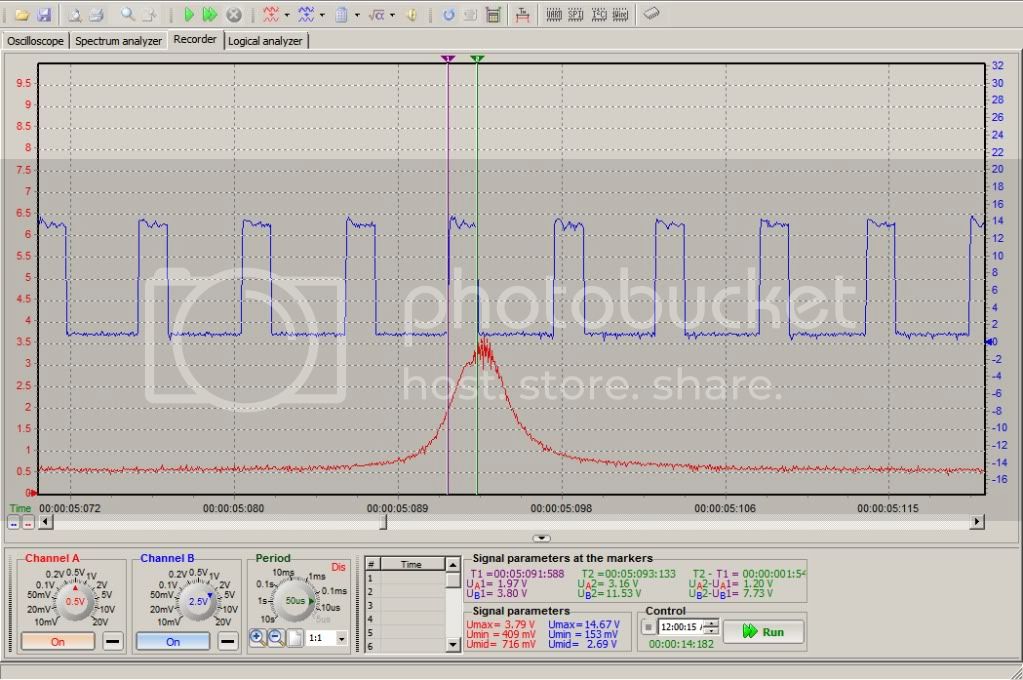

also..here's a couple of screen shots of the cylinder pressure with the 2 IDMs
STOCK IDM
HVHF IDM
