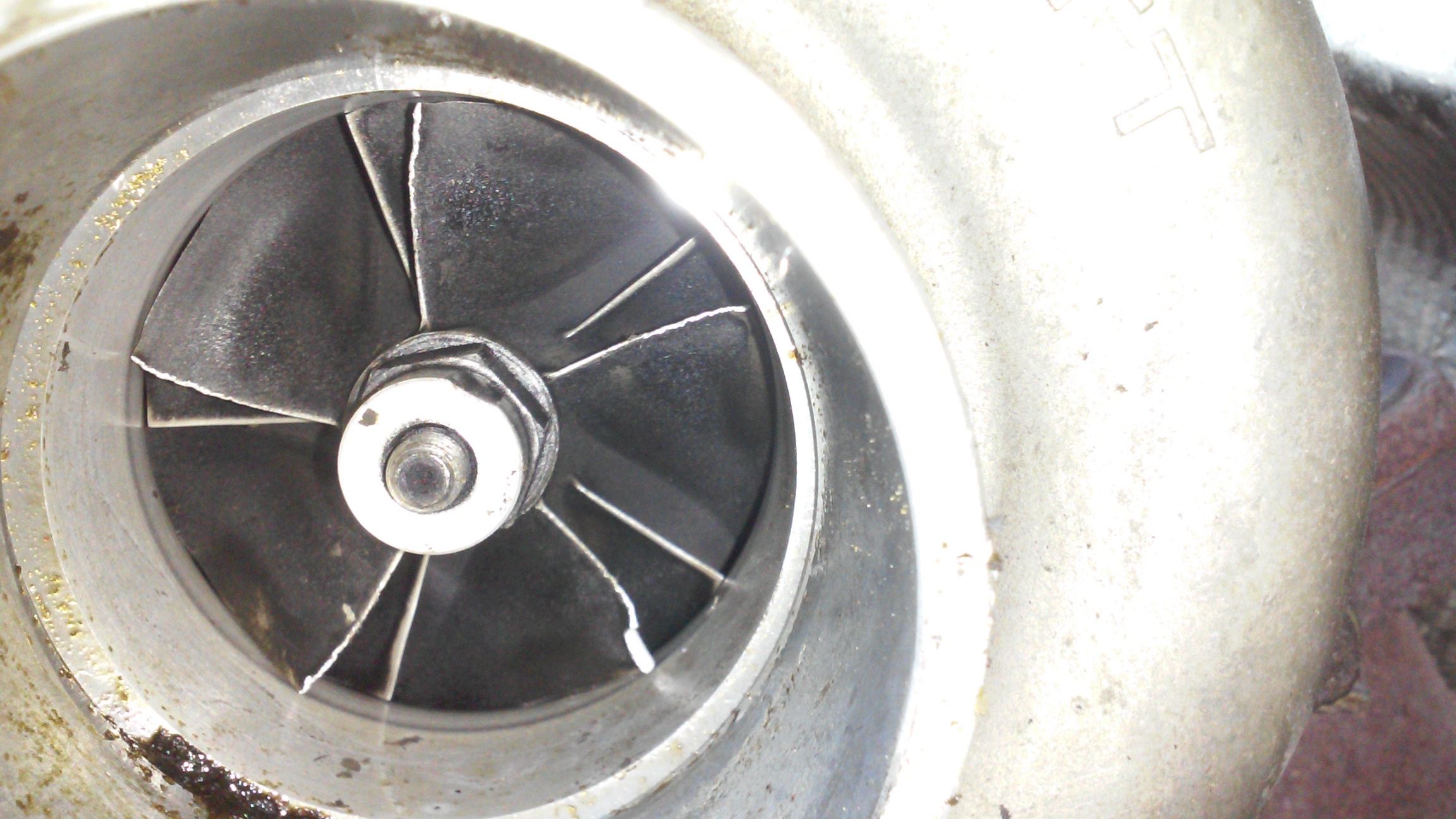

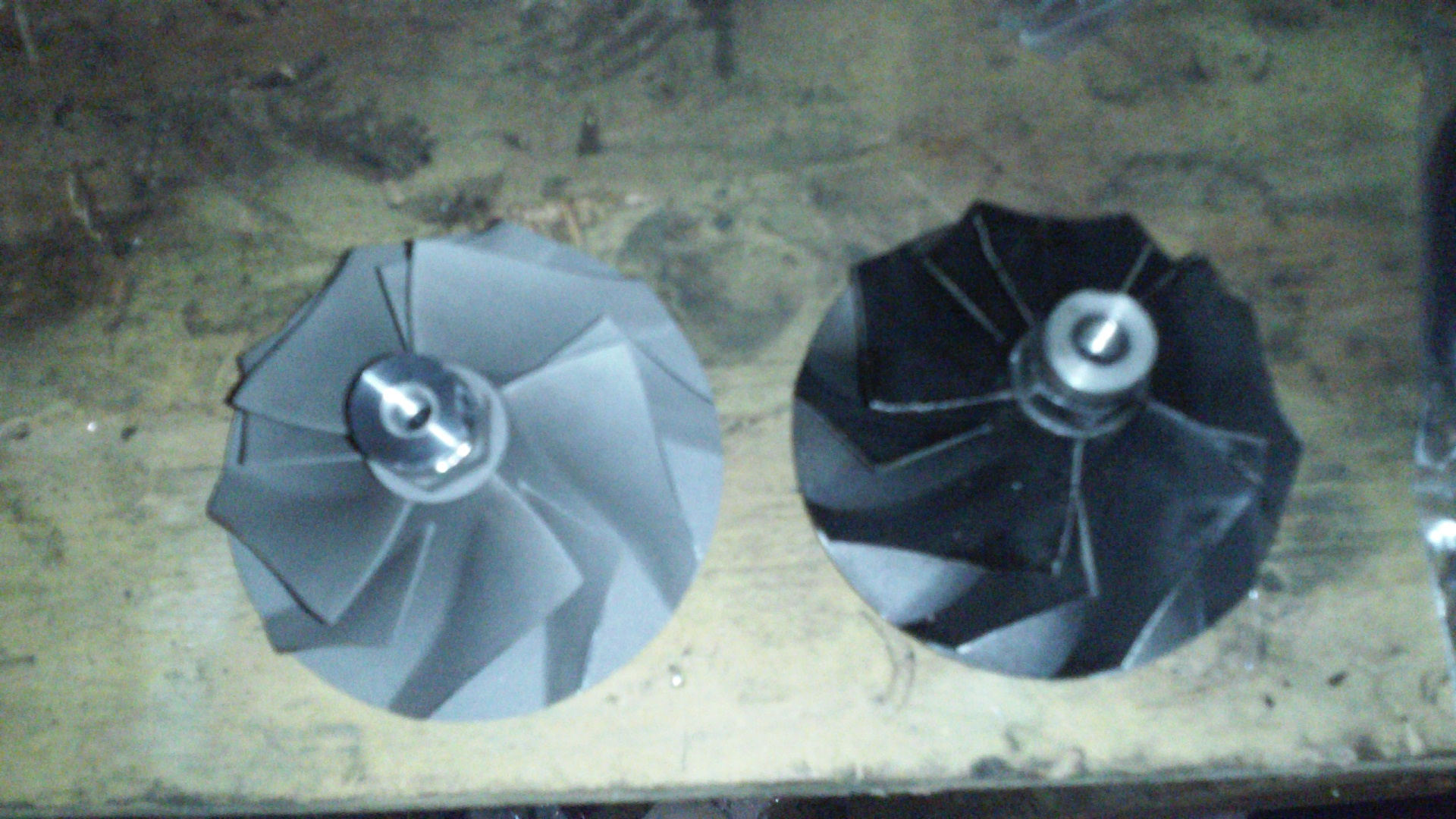

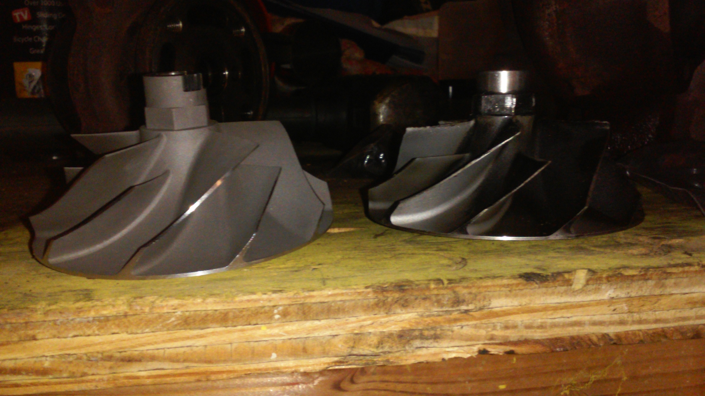

After I did some googling I realized that, but honestly the truck has been hauling a 46-51' trailer grossing 15-26k since 130k, so I'd like to get it compression checked and gone over before I put anything more into it right now.It takes 100$ and maybe 30 minutes to rebuild it...its already out for a wheel...so why not? With 315,000 miles on it(never seen a stock turbo last that long) it would be worthwhile to do. Honestly that wheel is not bad for its time. I have seen dozens worse than that, but yes it should be replaced. To be honest, you will likely notice little to no seat of the pants difference in performace.
Sorry if I wrote that wrong, they meant rebuild the turbo.If compression is awesome, why do they think it needs a rebuild.
Replace the EBP tube, rebuild the turbo and rock on.
