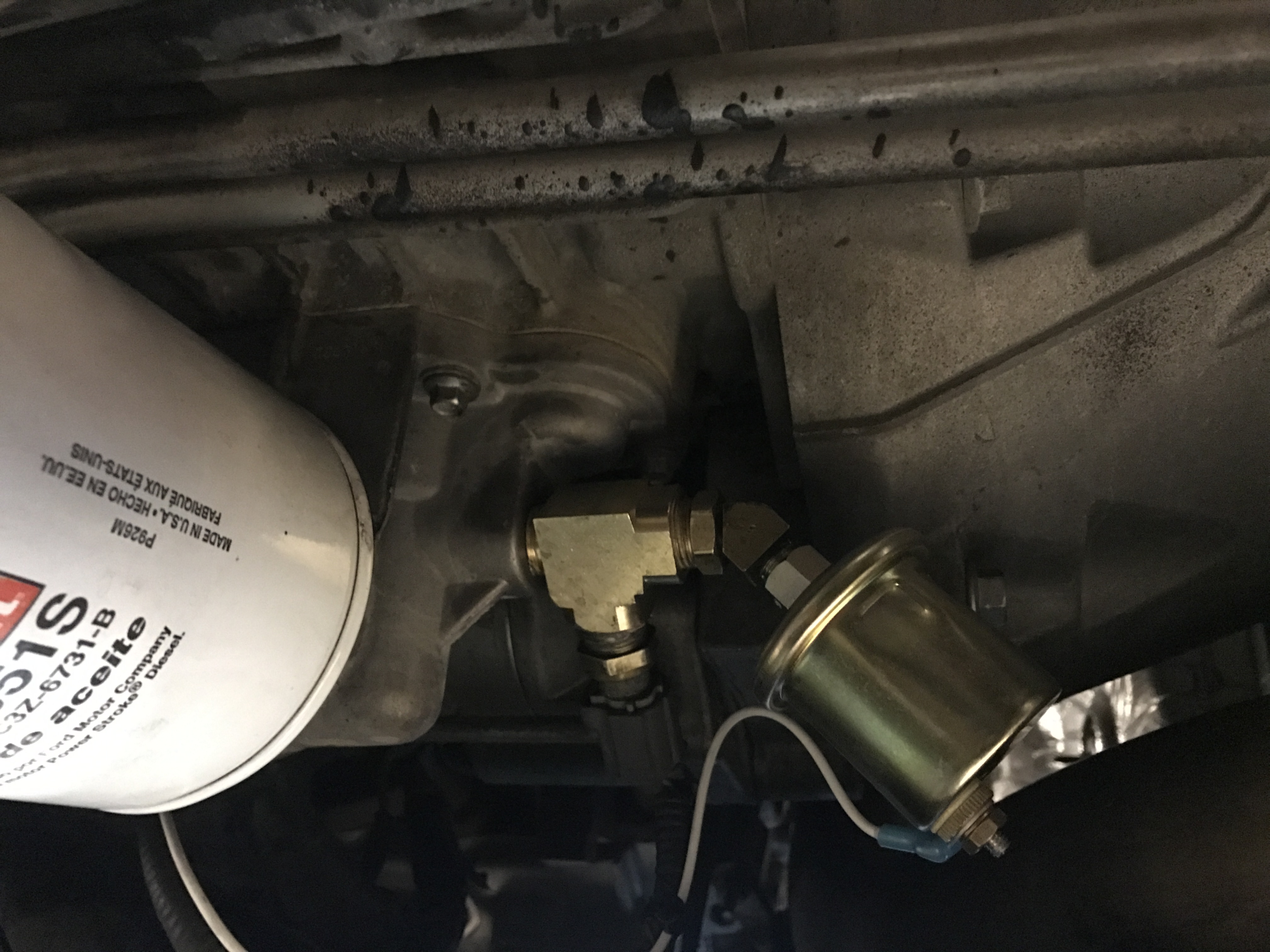

On a separate note, how many have or plan on installing an oil pressure gauge?

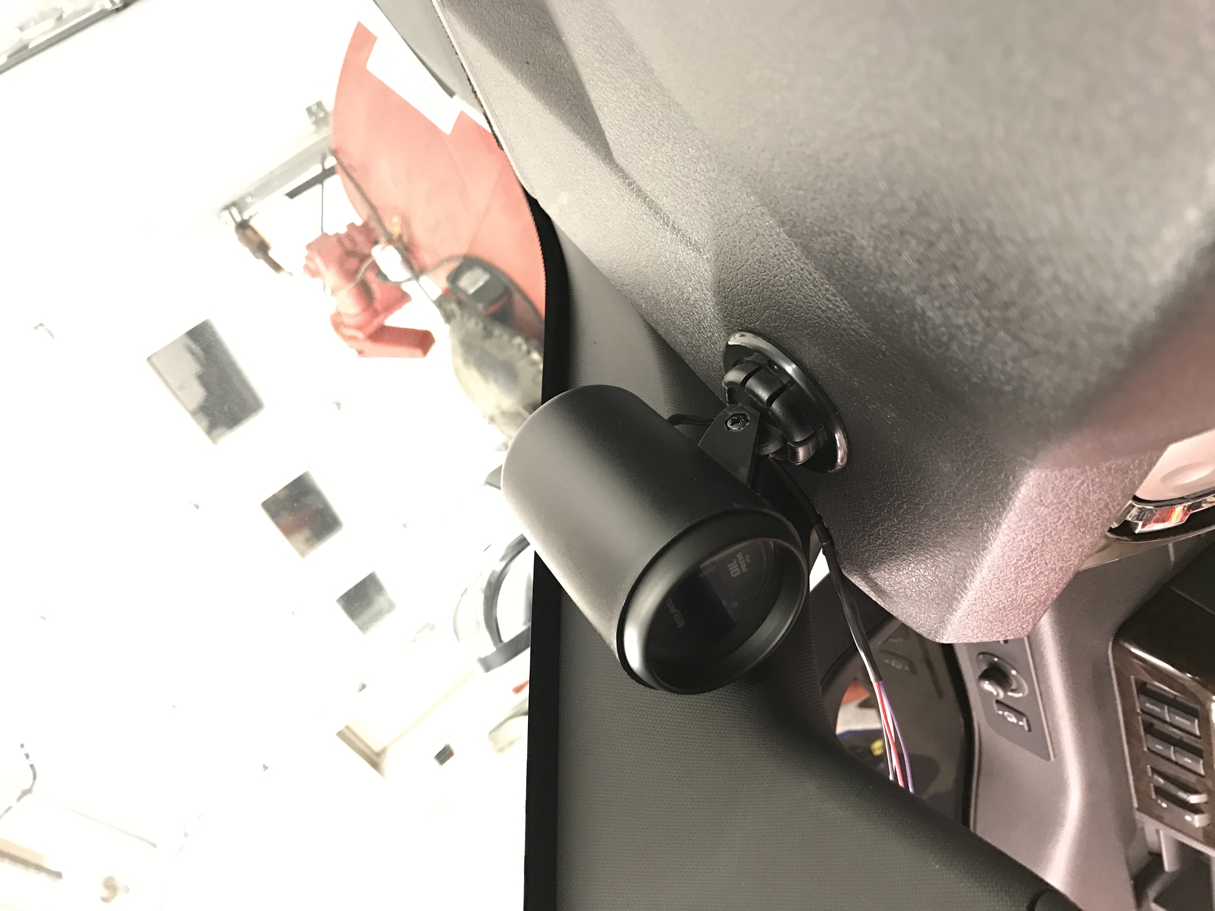

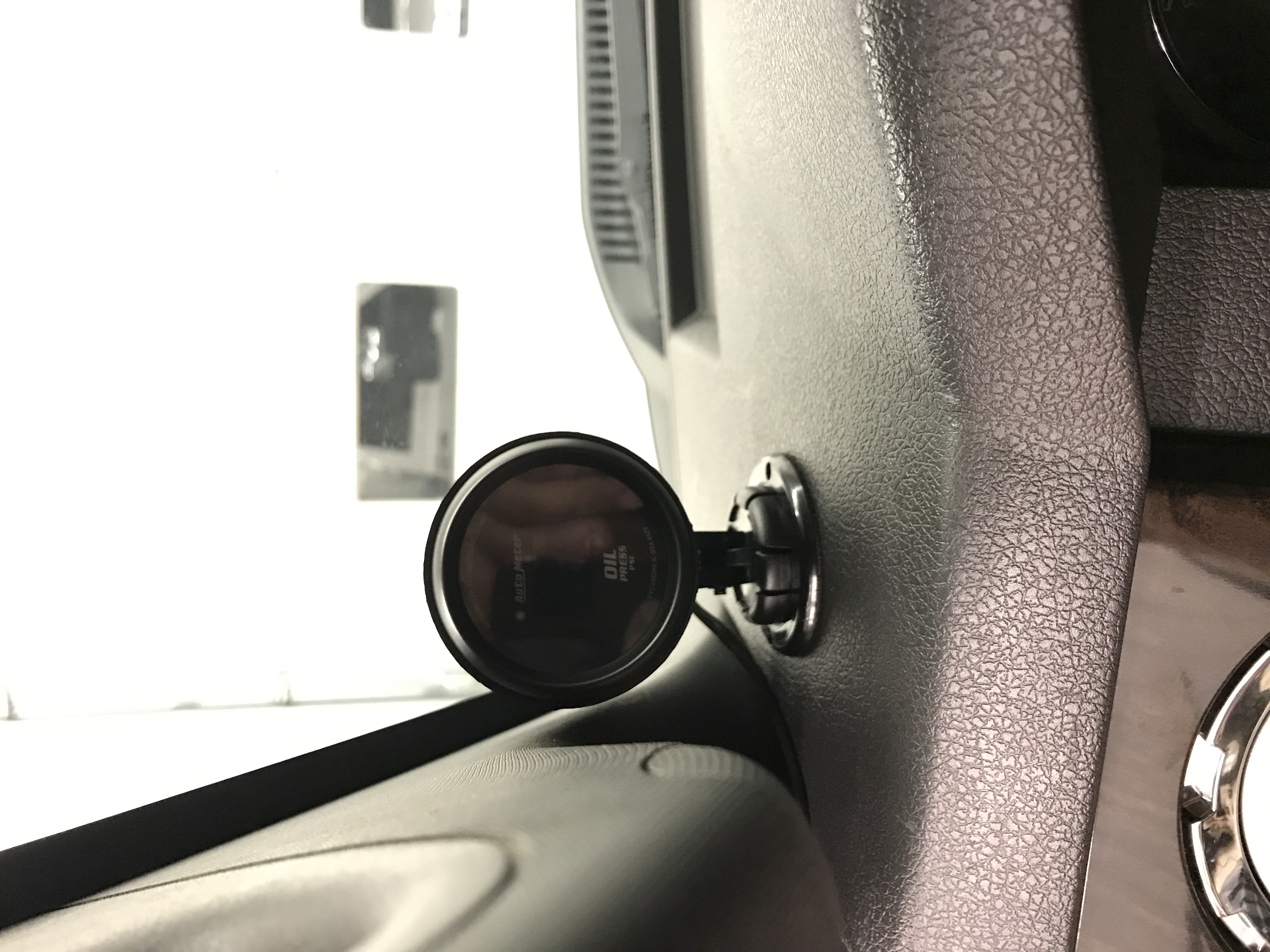

I have an oil pressure gauge I installed just for these reasons on my 2015. Also, 5w40 with 5 or 5k miles has the same oil pressure as 15w40 with 5 or 5k miles at hot idle, I don't remember who, but he claimed a almost 10 psi gain with 15w40 at hot idle lol
Jacob @ No Limit
Jul 26, 2014
746
Indiana
I see 28 psi at hot idle, seems well to me!

Where did you tap in for the gauge?
Id like to add a sensor to plug into mine that will plug into an edge cts2 when i get one.
Jacob @ No Limit
Jul 26, 2014
746
Indiana

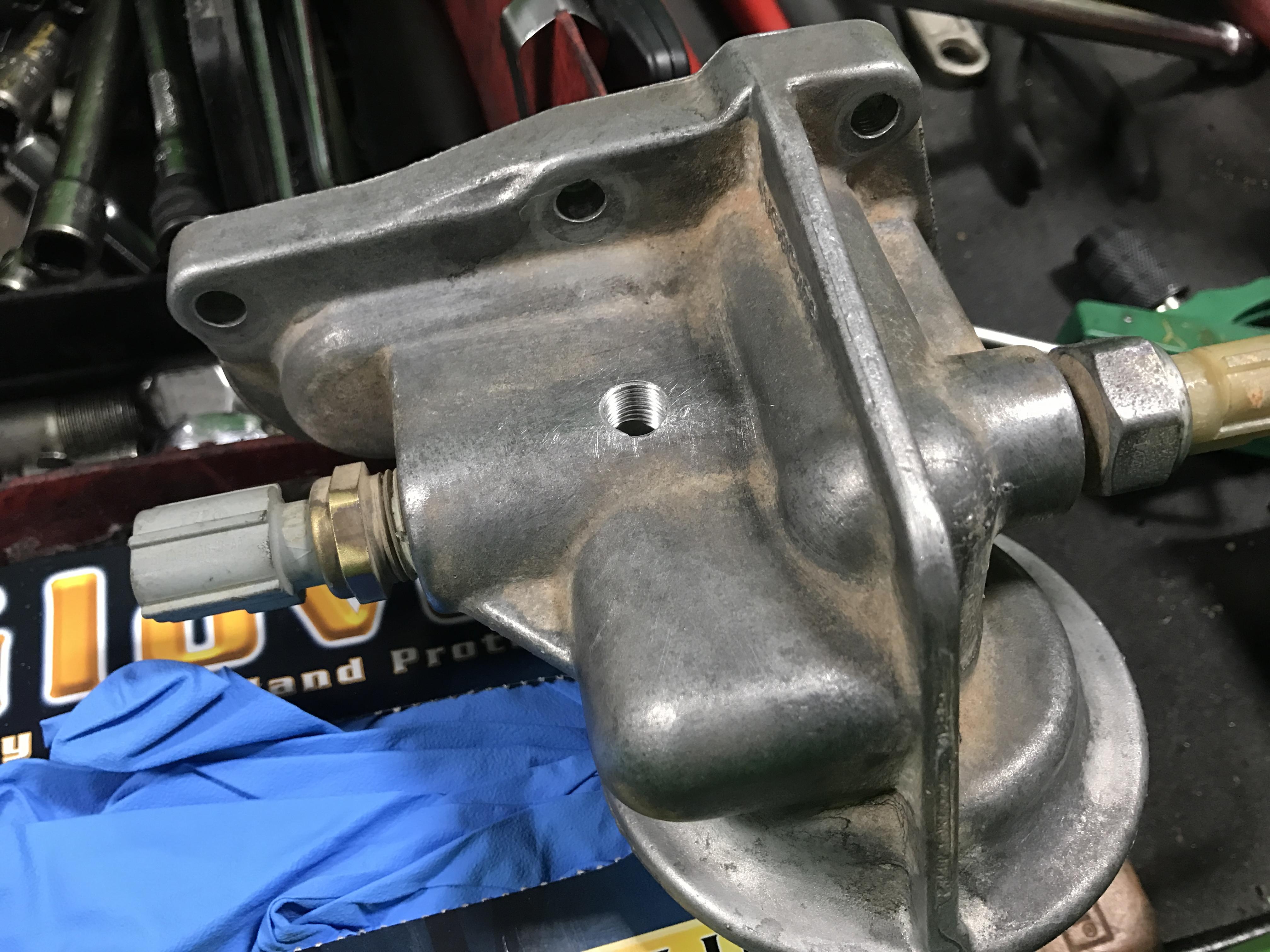

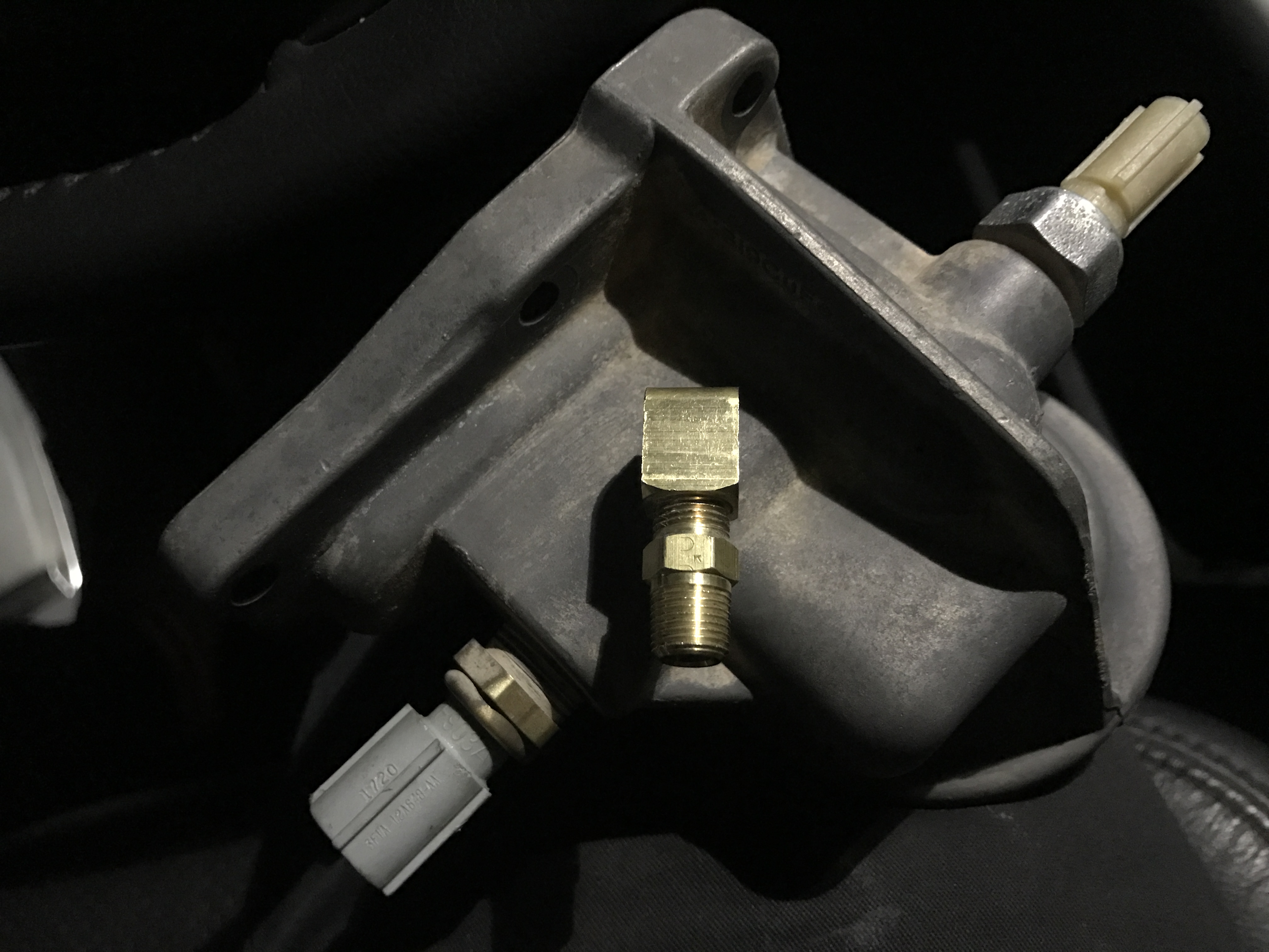

The first two pics show how I did it on the used oil filter manifold I bought off eBay, this is going on next oil & filter change. The last pic is how it is currently, you do not want to do it like this. It throws oil temp reading way off, much more than you think it would. Granted I have coolant temp reading on my ngauge, I'd still like to have the oil temp reading correct again, that's why I bought the second filter manifold and drilled and tapped it.
