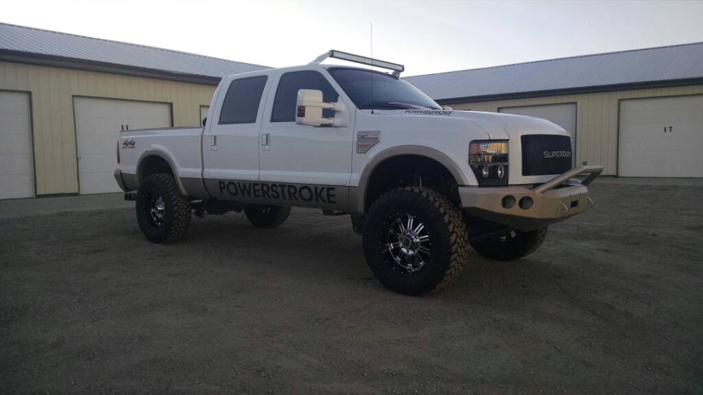

Kedstrokin
Jul 9, 2013
148
Moulton TX
4.5 rough country with 37s have some 22x10s I'm gonna find some 37s for and try that combo soon. No rubbing except on radius arm.

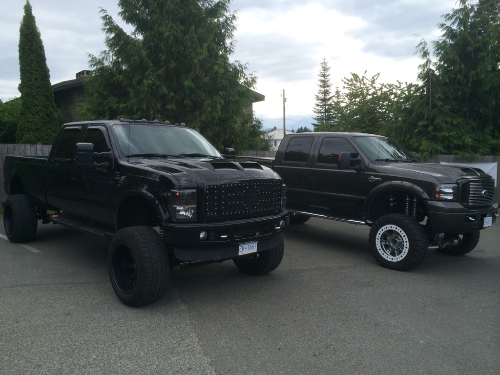

carson
Oct 1, 2012
44
West Coast (Canada)
. 8" lift with 22x14s w/37x13.5 wild peak a/t and 7" lift with 22x11s i believe , with 37" m16s

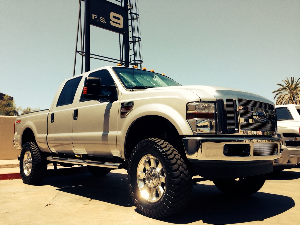

37's on 20x10's with -24mm offset with only 2.5" leveling kit....myth BUSTED! Looks like they DO fit no rubbing either.
