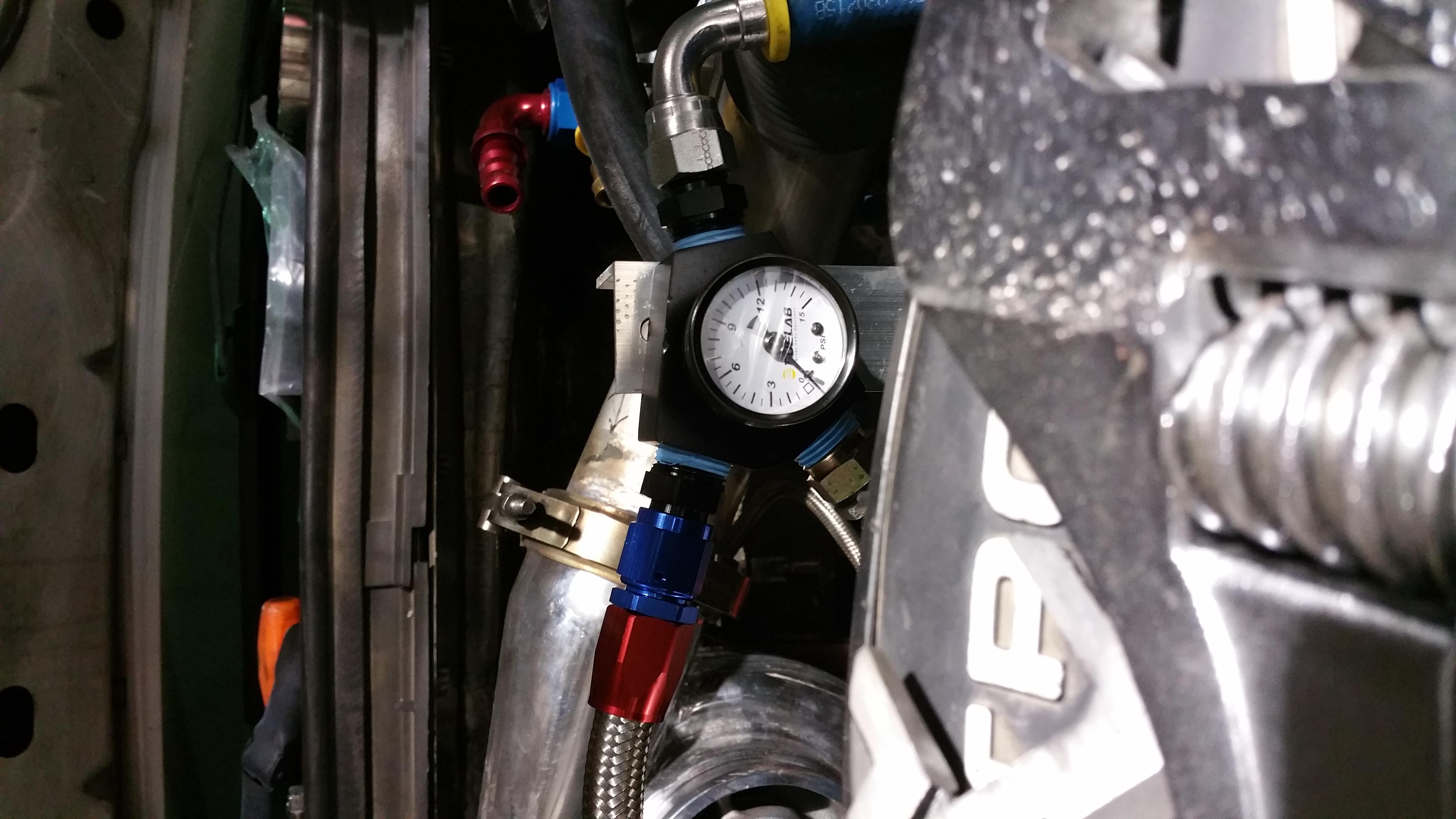

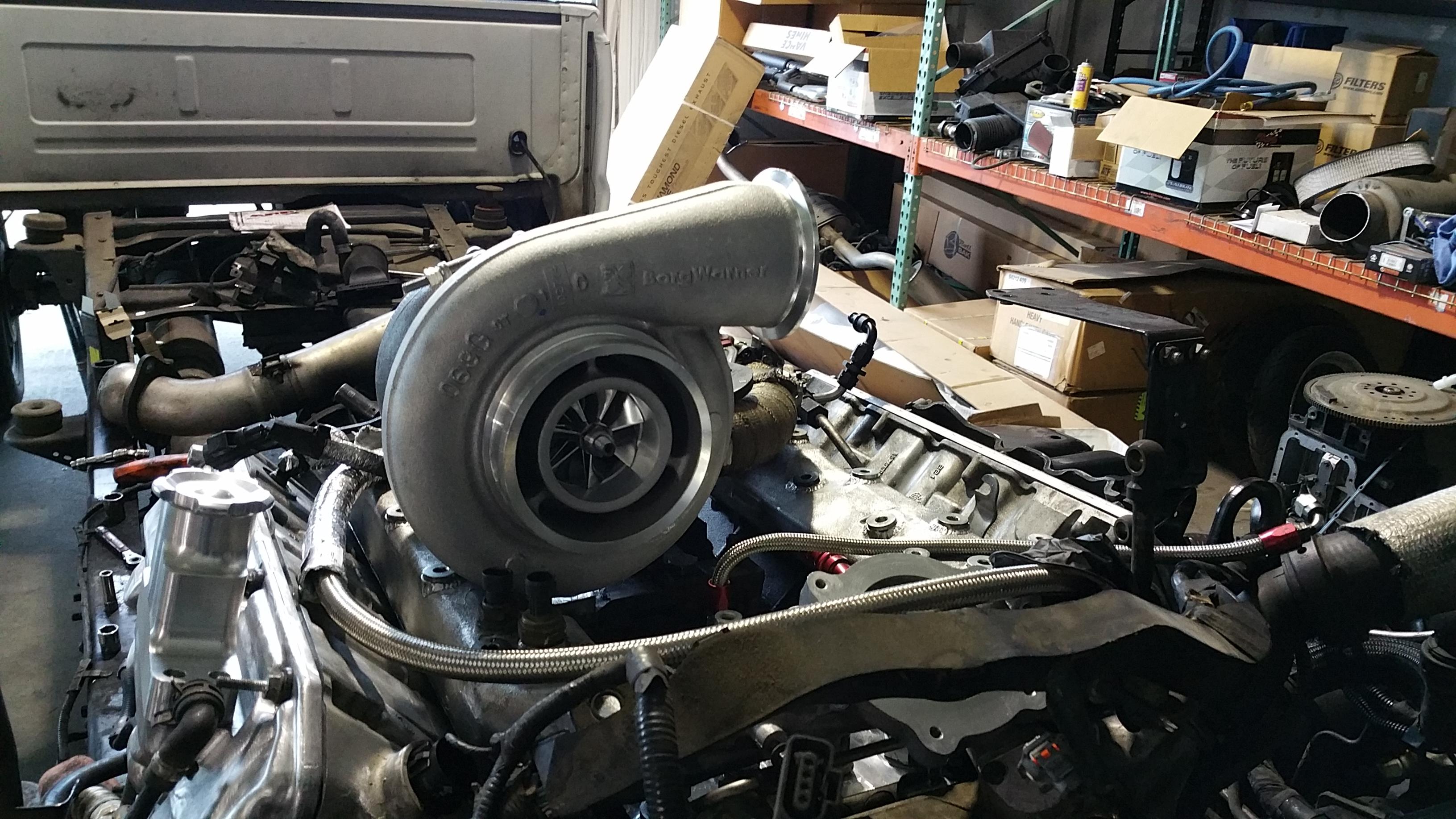

The HPFP doesn't like more than 10 PSI, seals will start leaking. Keep it below that. My FASS only puts out 7 psi right out of the box and that's plenty. I don't even have a regulator on it, just plumbed straight to the HPFP. You guys should look at the size of the hole your trying to shove all that fuel through on the HPFP. Whether its 5 PSI or 15 PSI you can only move so much fluid through that hole, however the increased pressure will blow past the seals and leak into the crankcase.

Curious to how your fuel is ran.. From lp pump straight to high pressure then from the return on hp straight back to tank? No cooler? Heads returns back to tank then too?
SEABEE08FX4
7,463
Montgomery TX
Its run from the FASS to a Y block, then straight to the HPFP. The return from the heads and the HPFP are tied together and go straight to a bulkhead fittimng in the tank. I replaced all the factory lines from tank to motor and back to tank.

This sounds like the ultimate fuel bowl "da lete", but I always wondered if doing this was too much for the HPFP's volume control valve.
How many miles do you have on this setup SEABEE & what is downstream of the Y opposite of the HPFP?
Thanks
SEABEE08FX4
7,463
Montgomery TX
That's the fuel temp sensor. And I'd say some where around 5k miles. As long as you know you're not pumping more than 10psi it should be fine. I did it unregulated as an experiment just to see, and it never goes over 8psi so I left it that way.

Willing to share some pics of the setup?
I'll have to take some, that's really all the pictures I took of it. Below is a list though.
FASS PN # FL-1001 ( 14' )
FASS PN # FL-1002 ( 14' )
FASS PN # STK-5500BO
Fuelab PN # 083-71502
Earl's PN # 361-9919EFG
Earl's PN # 361-921108
Vibrant PN # 22006
Vibrant PN # 16456
Vibrant PN # 10822
Vibrant PN # 10225 ( Two )
Vibrant PN # 22906
Vibrant PN # 10493
Vibrant PN # 22908
FASS PN # T F16 220G
capt dong
Mar 24, 2012
532
Houston, TX
I appreciate it. I was gonna give it a go myself. Those part numbers will help out a lot. I figure just connect the supply lines together and the returns together and put a gauge in there as well.
